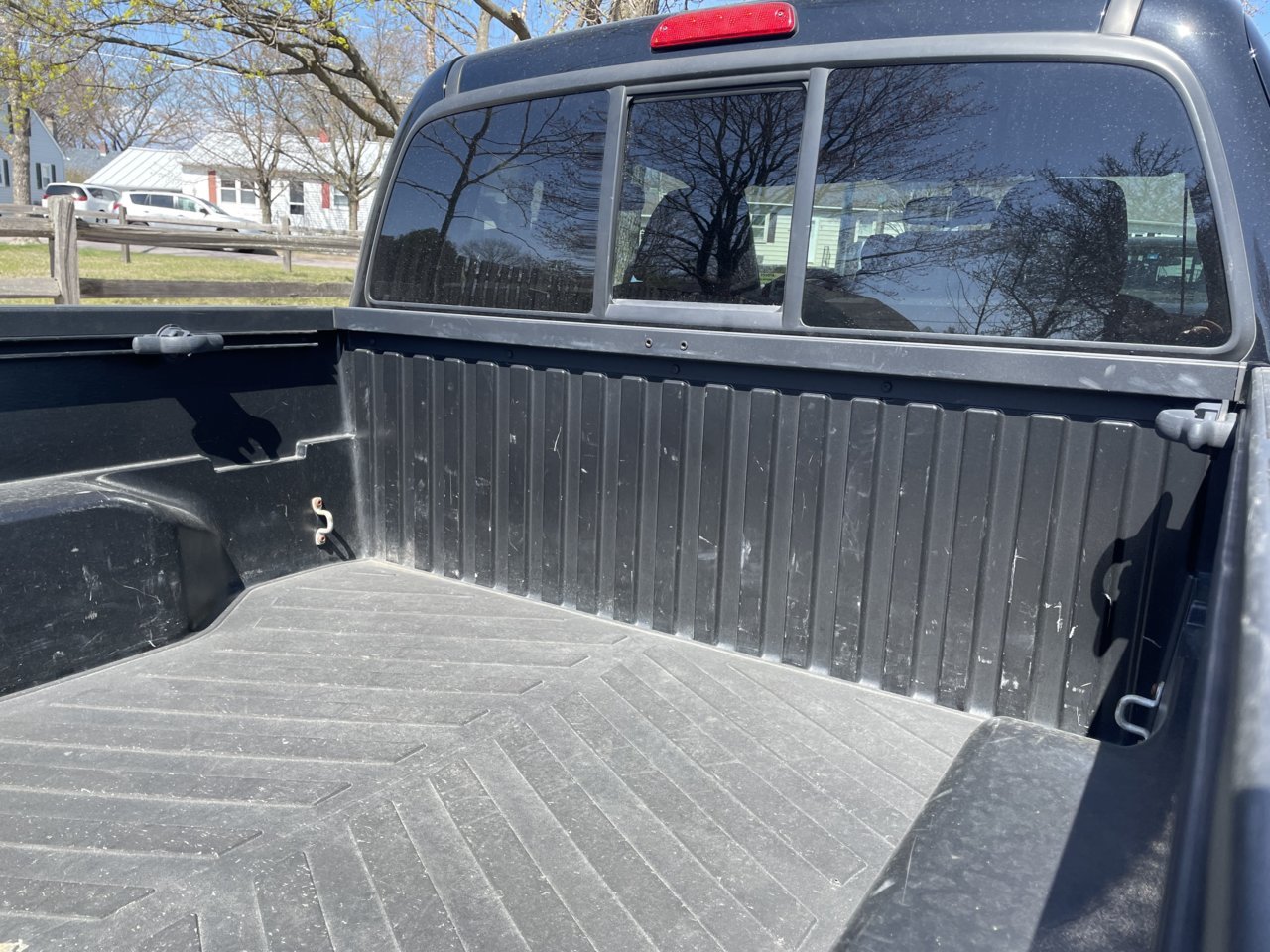

    I joined the 3rd gen club last week and noticed there’s no front bed rail. What gives? Is this just my truck or did the PO remove it?

    Front rail doesn't come on the 3rd gens but you can order the 2nd Gen one and the bolt holes line right up.

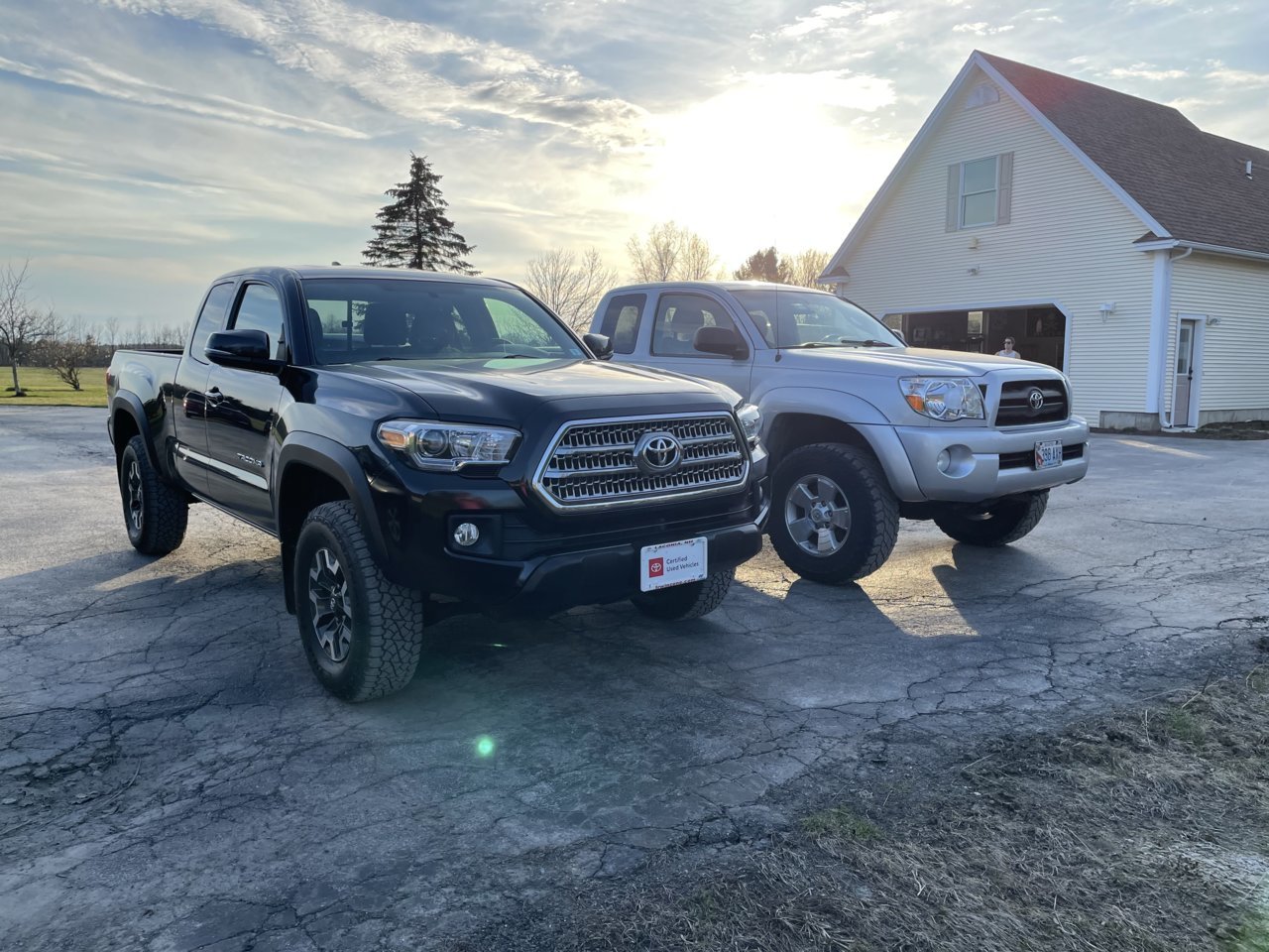

    Well lucky for me I happen to have a 2nd gen laying around.A4855A4B-2850-4795-8100-80CA0A9CDC6E.jpg

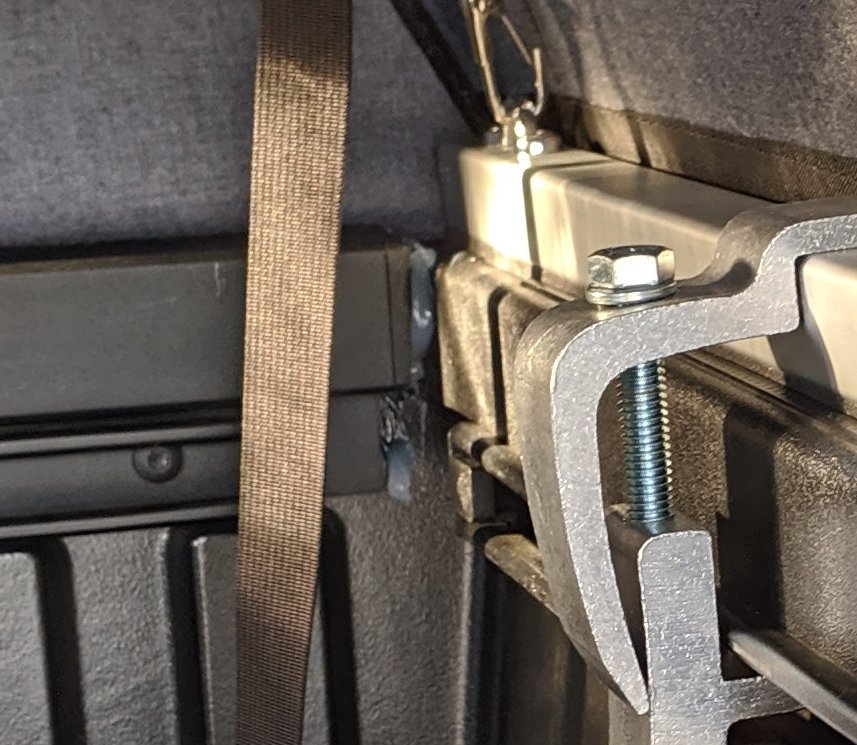

    There are some rubber endcaps for the header rail that have been posted here. I believe they are for the Toyota tri-fold installation? But even with those, you still need to add some goop.
    Sorry that I don't have a better pic, but this is the right corner from the day after the Softopper install. I picked that booger off later:
    Also, painted the mount rails and fittings matte black! :D
    I also sealed under the bed rails. There was a bit of paint wear in the contact areas from jumping over the side and in the back corners from the rails rubbing. I touched those spots up before putting the HD foil tape down.
