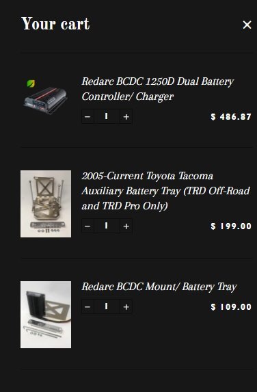

    I am looking into a 2nd battery option as well for my 2016 tacoma, its my DD, but I also like to go camping deep into the North Maine woods, and with soon to be added items diesel heater (for winter/cold months), a 12v fridge, added lights for campsite ( I am night-blind, so a little bit of light to direct me is good, nothing major, just a few small LED light strings, maybe a small work light at my tailgate for cooking meals in the dark/dusk), AND A 120V INVERTER FOR SMALL ITEMS
    my fear of draining a battery and being alone in the NMW for a few days is not a good feeling.. I do have comms (garmin inreach mini, which typically lasts 5 days or so.)..I was thinking of a dual battery in my 2016 tacoma with the offgrid engineering battery tray (with redarc 40A dc to dc charger)
    straight from them it looks to be about $800.. and I do plan to add the cascadia4x4 VSS solar panel @85 watts. which will maintain my auxilliary battery, and I plan to install a switchbox, so if I need to the solar can charge my main battery & disconnects the auxilliary (no fear of activating the dc to dc charger and draining my main battery at 50A)...
