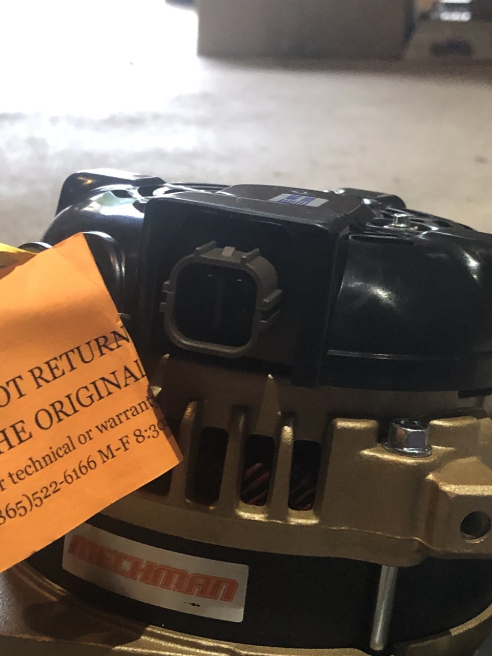

    here’s a few photos of the Mechman 240 I have waiting to be used as a bolt on replacement for my factory 180a.

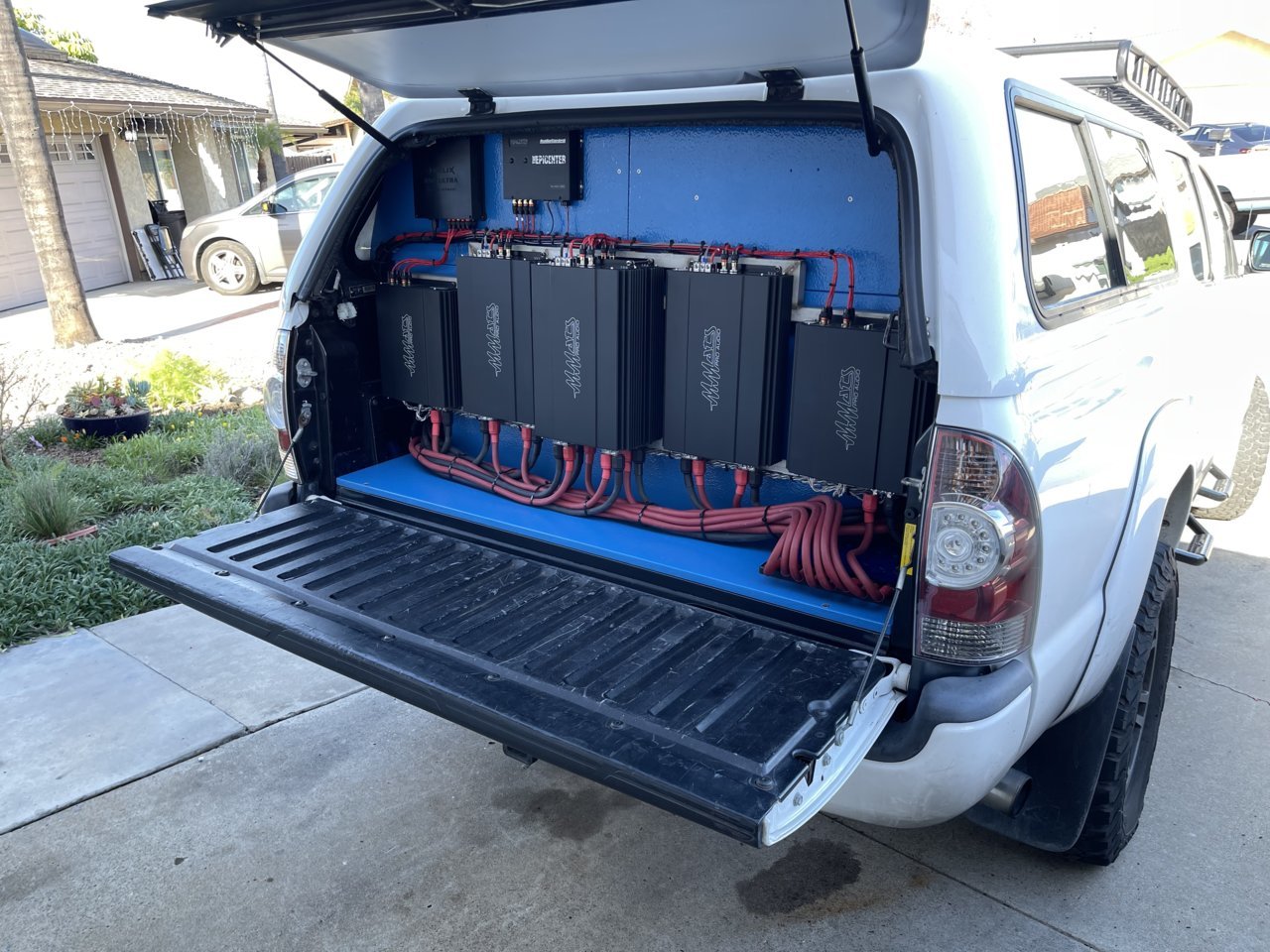

    Here are some pics. Specs are 4 15" MMats Juggernauts in a 31cuft series tuned 6th order. The amps are only mocked up in the pictures. I have been running it with a MMats m3000.05. My wife is an artist. She painted it.
    I will post more details later.

    @turbo598 would I be able to use my stock alt in conjunction with my mechman? That would be most cost effective for me.

    I tried to do exactly what you want to do first. I installed my DC power alternator and had my factory 130A alternator sitting around. I used my old alternator in the beginning to mock up everything and had 2 major issues.
    The first issue was the long mounting ear with the 2 bolt holes pushed the alternator to far away from the engine block. I had very little clearance around the alternator and a custom belt would be needed to make it work.
    The second issue was the location of the electrical connections. You can not access the wiring after the alternator is mounted without taking everything apart.
    The DC power alternator had the ability to change the clock position of the electrical connections because the back housing mounting ear was a separate bracket that could be moved. The factory alternator and yours have the rear mounting ear part of the casting. You can not change the clock position of the electrical connections using a factory cast rear housing.
    Making the GM Alternator fit was not easy either. Between mocking up both the original alternator and GM alternator, I must have taken off and put back on my supercharger belt/tension bracket, power steering pump, and factory drive belt 30 times.
    Install your Mechman. You will be very happy. When I replaced my factory alternator with my DC power it made a huge improvement.

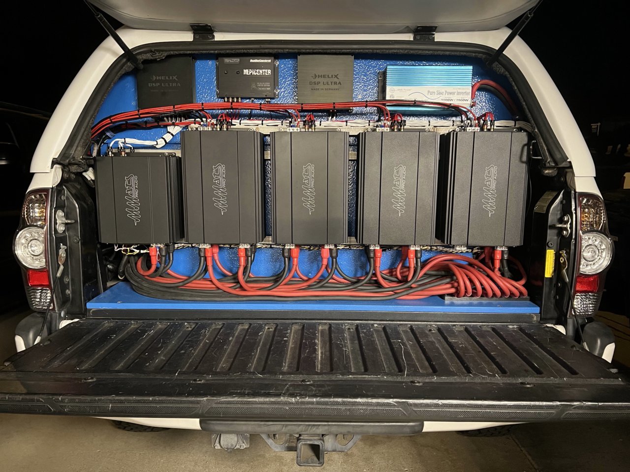

    Here are some pictures of the build so far. I will be working on the doors, and 5kw 120VAC inverter next.

    Here are some updated pictures. I will try to post some Demo videos.
