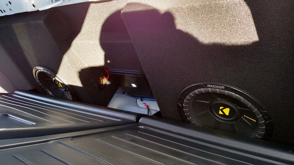

    Zac of all trades - do you have any pics of your system?

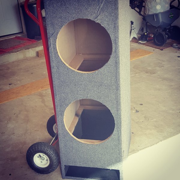

    I built it so when i fold up the bottom of the seats i can slide the box in ,on top of the storage bins.
