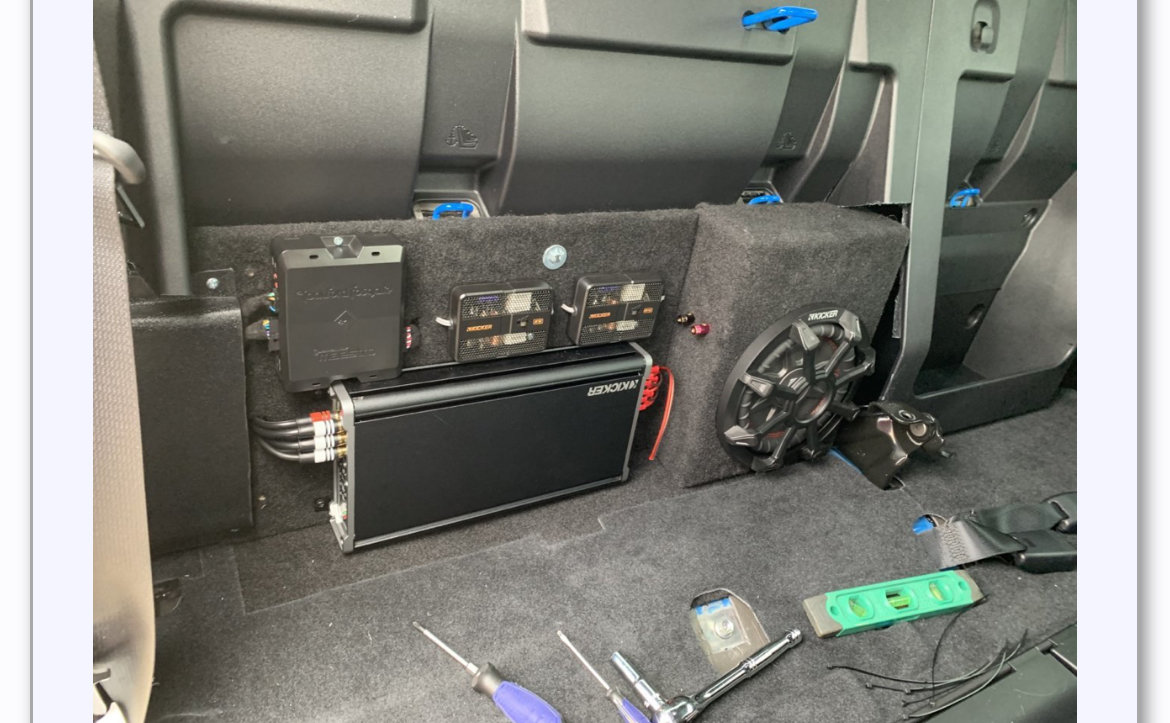

    This is what I ended up doing. I didn’t want a ton of additional bass so I just went with another 8”. It’s plenty for me and much better than the factory JBL. EEFBFD1B-B283-4DD3-A495-84DAB590126B.jpg

    Great looking setup. I am stuck on one part though. I am using the datalink harness (HRN-AR-T033), and noticed that there is an extra plug into factory JBL subwoofer to hook into the factory amp. There isn't a connector for this on the harness. I am guessing you wound up running new wire for your sub since you didn't stick with the stock box?

    It’s been quite a while since I installed my stuff so I don’t remember exactly offhand. If you can add some pictures of what you’re referring to I can try to help out.
    but my aftermarket sub is connected directly to my aftermarket amp. Nothing from the harnesses gets connected to my sub.

    thats a big amp for a such a small sub

    5 channel amp powering the entire system, not just the sub....

    Did you build up that box yourself? I'm looking to upgrade but I already have a radio setup under the seat and having the amp and sub mounted on the back wall there is a much better use of space even forgoing the sub performance.
