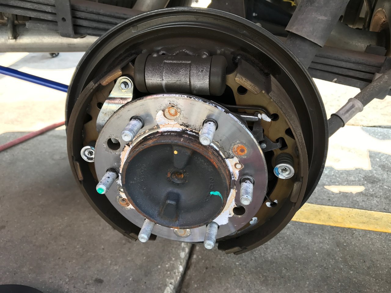

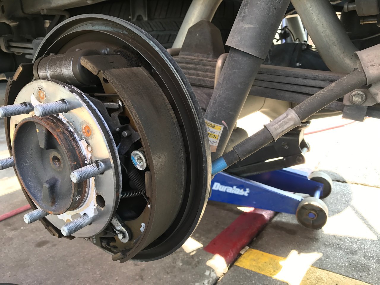

  18. Aug 11, 2017 at 6:45 AM
    #18
    Cheers007
    Cheers007 [OP] Well-Known Member
    Jan 12, 2017
    #207339
    270
    DFW
    2017 Tacoma Limited
    So I just had a chance to open the drums and all looked fine other than the usual brake dust that accumulates from the shoes. I sprayed brake cleaner very well, and then high pressure air spray from my compressor. Put it back in and squeal is completely gone.
    When I consulted with my mechanic, he mentioned that usually it's due to the material of the shoes that can do this, and even though it makes noise, nothing is actually wrong with it.
    I'll post some pictures of my open drums in just a bit.
