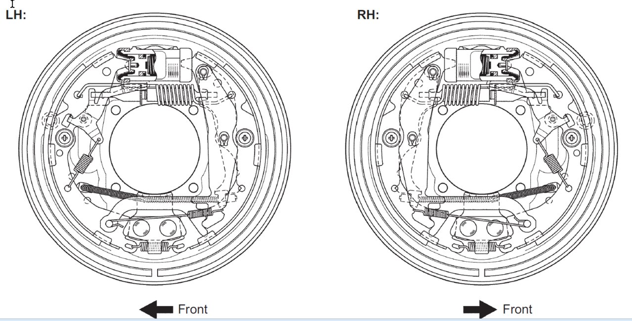

    I’ve already made a thread about this but I need some professional help now, I have clean out all the rust of the drum and clean all my hardware ( hardware looks fine) I bought drum shoes also and thought they were defective so I when and changed them. And took all the components off and did the drum brakes again and I still have the grinding noise. Could it be the I need a new rotor for the drum brakes? Or what could it be, it brakes good it’s just that grinding sound it bothering me

    Make sure that both sides are assembled correctly:
    hemitruk and whatstcp like this.
