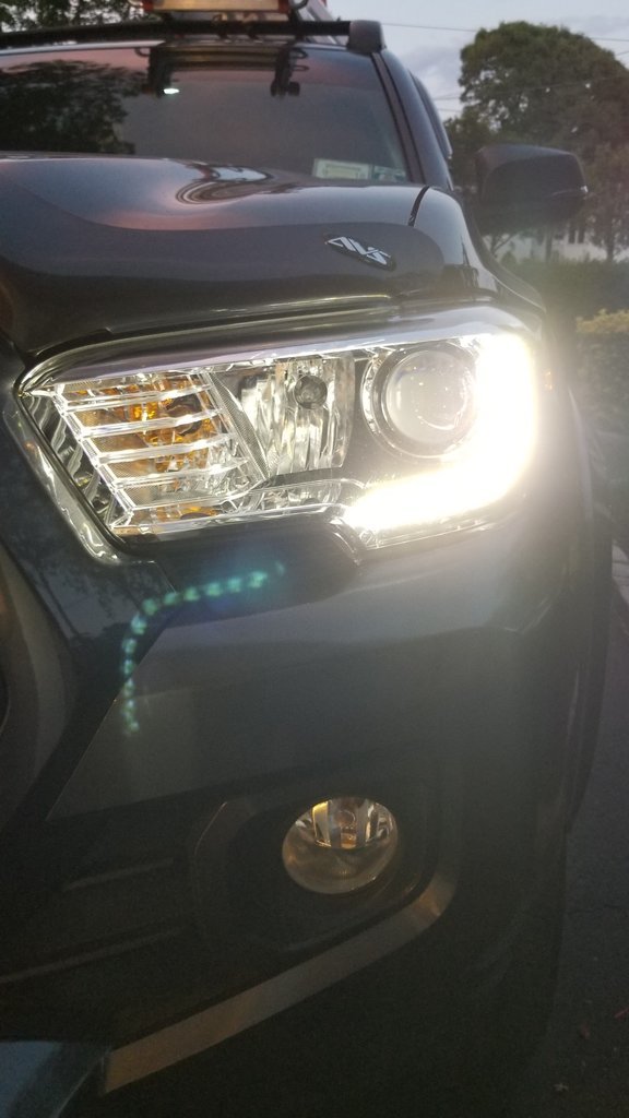

    -A.R.E. Z Series cap with power unlock, sliding and folding front window, -Custom wired cap LEDs from Recon with liftgate switch to trigger when door is open (switched with OEM cargo switch and bypass option for the liftgate switch) -LED Interior Dome Lights -Phillips LED Extreme Reverse Light -PIAA LED 6000k Headlights -PIAA LED 3000k Foglights -Cali Raised 31 in. LED Light Bar w CH4x4 push switch -Tint measures 5% in rear, 10% front doors, 5% top and bottom strips on windshield, under 5% on the cap glass. (Undone)-DRL mod to delete dimming when Headlights on -Debadged (Limited badge blacked out and moved onto the cap) -Piano Black Tacoma inserts on tailgate -Chrome delete on mirrors, grill surround trim, and fog light bezel with Avery Black Brushed Metal Vinyl Wrap. -Black vinyl delete from door pillars -Color Matched rain guards (out channel AVS) bug guard, and engine cover -ABS Thermoformed front Toyota and side Limited emblem. -HS MegaBlast Air Horn Kit. -K&N Drop-in filter -Pop and Lock power tailgate -Ceramic Coating Silver Package -Circuit breaker and fuse panel for electrical accessory protection -OEM TRD skid plate install -ARB OBA Single compressor installed onto the D/S deck rail (no tank needed) -CaliRaised Molle Panel, Full P/S Suspension: -OME HD Dakars -OME 888s -Bilstein 5100s all around, bottom setting -SPC UCAs
    They dim when the headlights come on. Quick and easy mod to keep them at 100% all the time is to short it by splicing the blue and red wires for the front DS DRLs at the plug. White is ground. I used a blue t-tap (hate those things) then wrapped in electrical tape. You only have to do one side so it tricks the computer. Test it with a metal razor if you want first. Man they are bright at night lol.

    Sorry it may be green not blue...20170703_203724.jpg 20170703_203757.jpg 20170703_203856.jpg

    Not to sound stupid, but could to u explain that a little better. Did you tie the green and red wire to the white wire? Possibly a pic of what you did before you taped it up.

    The LEDs come nowhere near to lighting up the road yes, but there is a significant difference in light when looking at the front of the truck at night. The white wire is left alone and the green and red wires were just connected to each other via a t-tap, no cutting or stripping needed. If you don't like how it looks it can be easily reversed by removing the t-tap and individually wrapping the wires with tape.

    Also it all depends on the angle you're looking at them, seeing that the headlights project the beam at a certain angle, whereas the LED DRLs outshine the headlight from standing height.

    The OEM DRL led bar has 2 power wires.
    The first supplies 12V during when the switch is set in " DRL " position. They will light up at 100% brightness. When you switch to "headlights the DRL wire shuts off, and 12V is supplied to the other wire instead. The DRL's then only Illuminate at 50% brightness. Splicing the 2 wires together makes them run at 100% all the time no matter what position the headlight switch is in. Be cautious, as they can be very bright at night. Unlike your headlights, where there is a cutoff to prevent glare to incoming drivers, the LED DRL shoots light everywhere and can be obnoxious to others on the road. (They dim for a reason)
