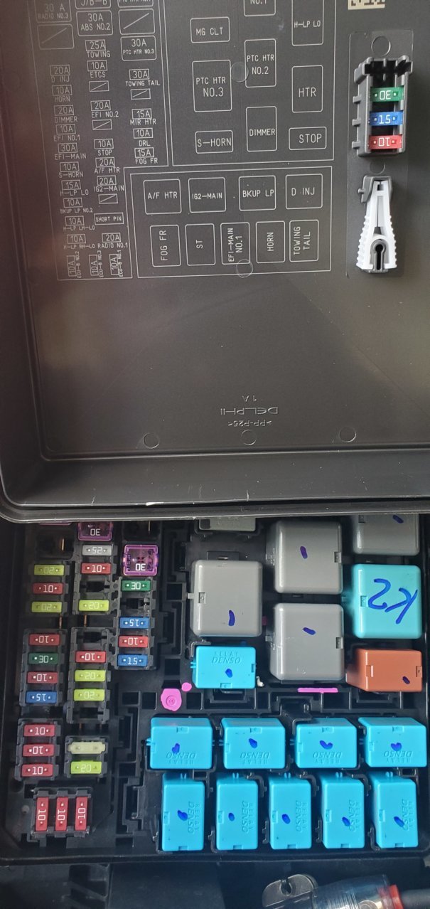

    Read your previous thread. Here's a picture of my fuse box. I have a 18 DCLB 4X4 OR and my 10amp DRL does have a fuse there, but no idea why you're doesn't haha. Just an idea, turn on your DRL and check to see if there's any power going to that empty slot (and voltage drops when turned off)

    If you don't have LED DTRL then no need to have a fuse there...

    Ahhhh ok. So trims with LED DRL will have a fuse in the "DRL" slot.... trims with non-LED DRL will be lacking a fuse in the "DRL" slot. I'm guessing they are wired into some other circuit then. Thanks for the input!

    You are correct. The Turn Signal Lamp (incandescent) that your vehicle has uses a dual filament bulb. One is For DTRL & Signal, the other for "Tail".

    DRL's are behing the relay(small fuse box under the hood). That DRL fuse is constant power circuit that feeds relay.
    To tap to DRLs, need to splice wires
