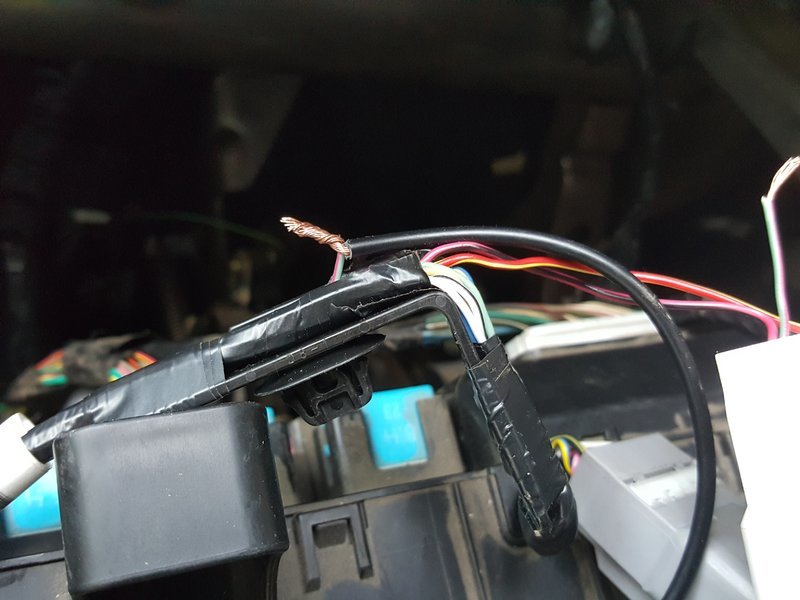

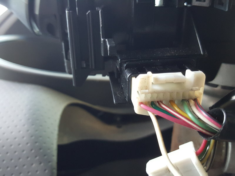

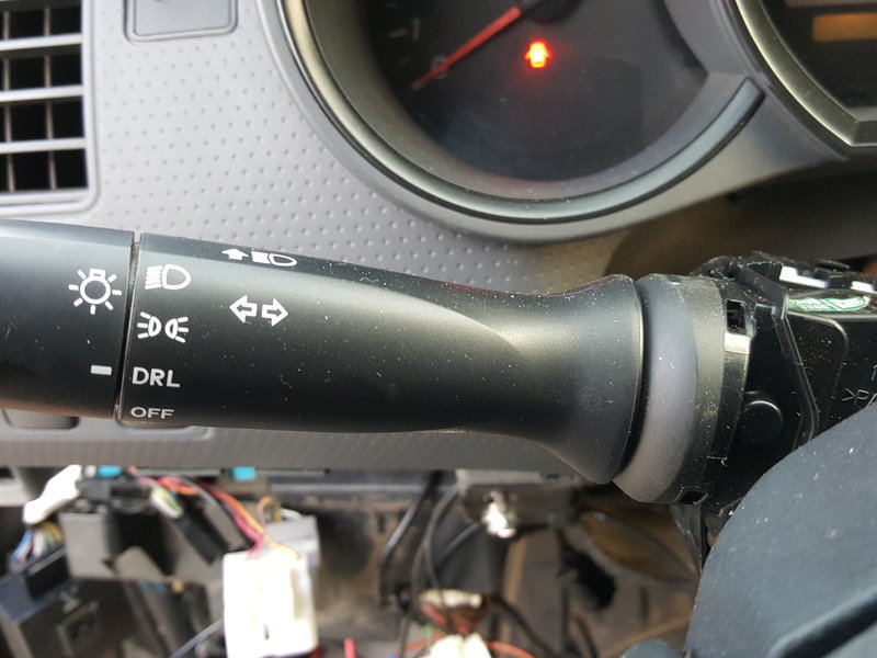

    hey tw I have successfully installed the oem 13 headlight switch with the drl off option[​IMG]. the 05-12 are missing 1 white wire.[​IMG]I had bought a 13 steering column with wheel and everything was plug and play except the white wire wasn't there. so I ran a extension wire from the switch to the drl harness.[​IMG]I cut the green with red stripe wire and deleted it out of the white plug. I was going to just put in a plain jane switch but I wanted it to look more factory. thought I would share this for those who are interested.

    So are you saying it's possible but need to splice in an extension wire? Why did you need to delete the green w/red stripe wire?

    it is possible you have to run a wire from the switch to the drl harness behind the fuse panel. I deleted the green/red wire because it was no longer needed for power supply, that came from the switch itself

    Ok, I have the new (old) switch and it works as expected, without the DRL-off option on my 2015. I'll be putting my stalk up for sale as soon as I've completed the swap this weekend. New OEM is $80+ shipping, I bought mine for $40+shipping and am not interested in making a profit but would like to cover my costs. PM me with an offer if you're interested (part is coming off my 2015 with 32k miles, and has the four-position switch including both DRL and off)
    Note - to swap the stalk I think removal of the steering wheel is required. Working through that tomorrow when I have daylight and a few cups of coffee. Updates to follow.

    ......and not quite working as expected.
    For my 2015, I'm using a stalk from a 2012 that has the three positions - off, parking, on. I was expecting that off meant DRL, but off really means off. So, my DRL never come on with this stalk. Based on my subsequent testing, I can confirm what desertrunner24 said regarding the white wire - I have a white wire in that exact position and confirmed that is powered when using the 2015 switch in the DRL position.
    The only visibility I have about the 2012 wiring is the stalk, and that's not enough for me to figure out how the wiring harness might be different. I'm guessing it might be related to desertrunner24's mention of the green/white wire but I'm not sure.
