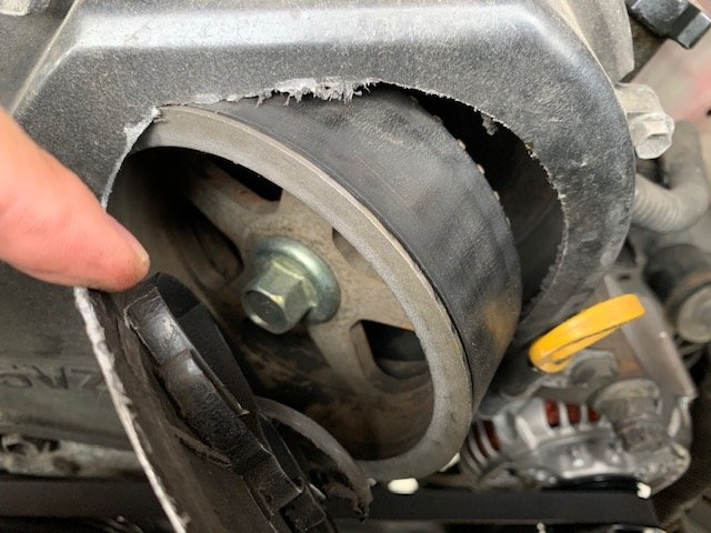

    My mother in law has a 2002 Tacoma ext-cab trd prerunner with v6 5vzfe and auto transmission. The chassis has 384k miles on it, and she had the original motor replaced with another one about 2 years ago that supposedly has under 100k miles on it. She was driving on the freeway the other day when the truck just shut off on her and luckily she was able to coast it to the side of the freeway. upon further inspection it appears the drivers side camshaft pulley sheared off the camshaft. she states the oil light was flickering a few minutes while driving before it shut off. I checked the oil level and it is normal level and doesn't look dirty, could it have been caused by sludge or failed oil pump? the engine still turns over. do you guys think it is repairable or does it look like we need an all new motor ? unfortunately the warranty she had was only for 12 months. she is on a fixed income and I will be trying my best to help fix it for her if I can. thank you guys
    attached are some photos of the carnage

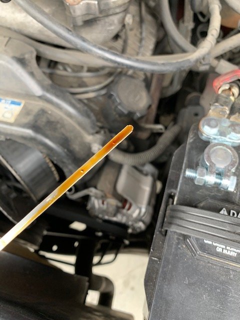

    That oil looks way overfilled.
    Too much oil can cause frothing and starve parts of proper lubrication.... i'm wondering if that's what happened here.

    I bet the cam pulley didn't get torqued down properly and developed a bit of a wobble. The oil level looks good to me.
    I'd try to get a salvage yard camshaft and cam pulley and a new timing belt and put it all back together. Bet it's fine.
    Might go ahead and get the camshaft sensor in case yours got damaged. I don't remember if cam sensor is on driver or passenger side.. probably driver.

    I'd be weary of the oil pressure light coming on. Once you pull the camshaft you will likely be able to see if it got hot enough to discolor the metal or not. If it did, it would have been being starved of oil.

    You are missing something there. Oil starvation affects certain areas faster than others. The front oil passages of that head are farthest from the oil pump, and starve first. That head is toast. The other head is probably about to be toast, and the bottom end most likely took a hit. That was not caused by a 'wobbly cam gear' but by the cam seizing in the journals, instantly destroying that head and snapping the gear off.
    The flickering oil warning light, at speed, is not a red herring, but the root cause.

    Does anyone else really not see how overfilled the oil is? Im not talking about the super long thin line but up above the "Full" hole where the oil still covers the width of the dipstick.
    I'm sticking with the overfilled oil caused the oil to be aerated and the flickering of the light was caused by the suction of oil foam at times and actual oil at others.
    If a shop performed the last oil changed they should be held accountable.

    nah, I've seen one filled to overflowing before. It smoked like a mosquito truck though.

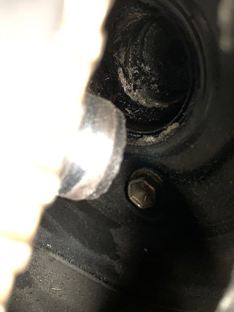

    sorry for the delayed post just it’s been slow with everything going on right now. I finally got to tear into the motor and 3 of the front journals are burnt. What do you think caused it? Oil pump failure or sludge? Any chance the bottom end is salvageable ? I already got new heads to replace the old ones

    Here are some pictures of the drivers side head. After taking the burnt cap ends off I could spin the camshaft with a wrench. I could spin the bottom end by the crankshaft pulley as well as the passenger side camshaft to bring them to tdc
