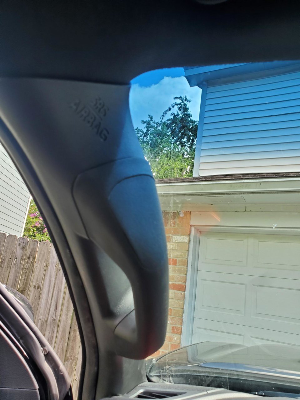

    I bought the KTJO 4x4 grab handle for the drivers side.
    $256.28 w shipping. I received in 3 days after order.
    https://www.ktjo4x4.com/product/3rd...order-driver-s-side-grab-handle-w-a-pillar/22
    This is a necessity for a truck like this, no idea why Toyota failed to install one.
    But... this grab handle is very poor quality from KTJO. The color matches perfect, but the holes do not line up properly. Once installed the handle and trim piece are all uneven and do not line up properly. They did a terrible job reverse engineering the hole locations. I will still keep it as it is really functional.
    This entire install would be less than 5 minutes if the holes lined up. I spent 45 minutes trying to get the screws in.
    If they would just add in a chamfer at the end of the screw then it would go in easier. It would have been nice if they fixed their mold so the holes aligned properly.
    The instructions do not tell you how to install the bushing and washer.
    I installed the bushing first, washer on top of it, and then put the screw through. See the pictures.
    When installing, use pliers to pinch the clip tight before you install it. This will ensure it wont move and help prevent bending when you keep trying to thread in the screw.
    Also, test fit the screw to make sure it is aligned and goes in easy before you install the trim piece. This will also let you get a sense of the angle you need to install the screw in as you cannot see it after the trim piece is installed. You need a weird angle to install vs the hole on the trim piece as they are not aligned.
    When installing do not push the screw hard or it will bend the clip and then you have to start over.
    Also, install the front screw (front as in closest to the driver) first and leave it really loose. Then install the back screw. You need to keep the 1st screw loose so you can jiggle and move the handle around to get the back screw started.
    All you need is a 10mm socket and some kind of pliers to squeeze the clip.

    Will this smack you in the face when the side curtain air bags go off ? Will those bolts limit or change the trajectory of the airbag?

    The airbag under that cover is the curtain airbag and it deploys downward between the window frame seal and the plastic A-pillar cover so as long as the A-pillar cover is not of any significantly stronger plastic I would doubt it will make any difference. That airbag is coming out between the cover and the window no matter what.
    The 2nd gen Tacoma has the same A-pillar and airbag along with the factory grab handle assembly.

    Seems like to me that it would do the exact same thing as the passenger side or the original trim piece as the plastic has the same thickness. The airbag shoots out the side toward the window.
    But....I have no idea since I was not in an accident.

    Splurge and get a decent J-clip. The one they sent me, like the one shown in the OP, was the cheapie kind. Plus, it was the wrong size. A quick trip to Ace Hardware, and a few cents, will get you the one you want. Don't bother writing to KTJO about this. That's a waste of time.

    One the first few pages it shows an airbag deployed with the original trim and comments saying the gen 2 has the same grab handle. Seems like this would not change the airbag deployment. If there is another post saying it is bad then provide a direct link.
