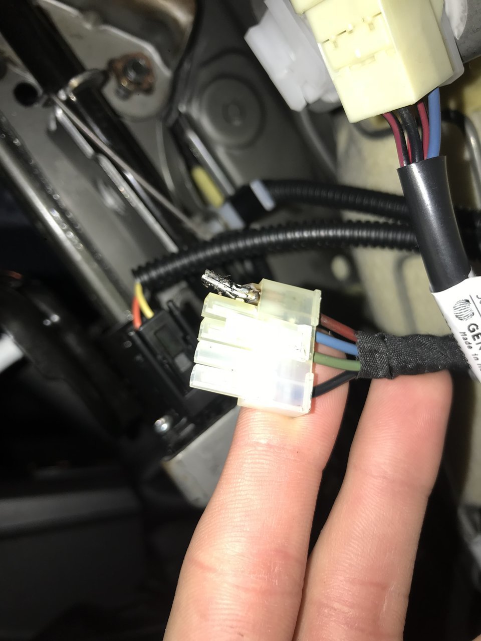

    8C8E2DF2-38B6-42E3-A2D8-2AB34E96AC59.jpg 5FB4F4E1-6467-4E0C-99DD-C374BCC179F2.jpg
    There’s the problem lol

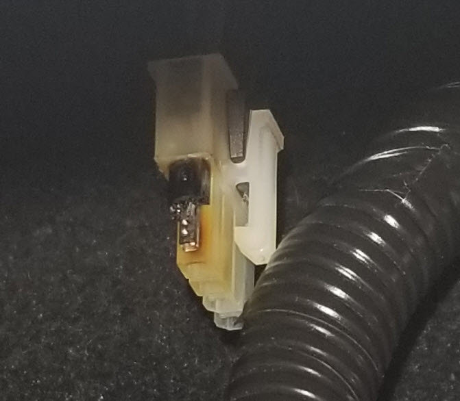

    After prying the module box out from under my seat to find the same thing you’ll found. Here I sit at the dealership with that box in hand with the burnt socket holes.
    They tried to charge me $50 to have a tech look at my seat to tell me it was burnt out!
    “You know”
    The part that I was holding in my hand.o_O
    4C151847-6B97-42FA-A7EF-E0551F9FB42B.jpg 0DB76D6C-7DA7-4DA0-8327-358A99A1860A.jpg
