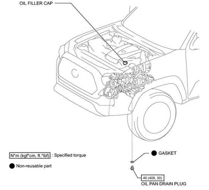

    Whats the torque spec on a 2022 2.7l Tacoma oil Drain plug? And does anyone actually torque there drain plug?......looked online its all over the place from 20-30 ft lbs......trying to find diagram with no luck.... Also do you replace drain plug washer everytime you change oil?

    It's 30ft lbs, but I'd suggest 25ft lbs if you are using a torque wrench.
    Honestly, the rule of thumb is just snug. Not super tight, just snug.

    Sup fumoto guy. No oil related thread is complete without a fumoto guy. At work I’m required to torque to factory specs when doing an oil change but I agree with bishop 25 is good. On my own stuff I just snug it down and call it but doesn’t take much to hit that though. If you snug it to what you think is good then check it with your torque wrench you will probably find you are over torqued little bit.

    I just approximate these and remember 3 numbers: 10, 20, 30
    10 being the tiny little metal cap, and honestly I never torque it, just hand snug, that's it
    20 is the entire filter housing that I use a torque wrench, but only torque to 17 because I use an extension there, and it might amplify torque a little bit so 17 is good enough
    30 is the drain plug, you won't have problem torquing it to 30, jiffy lube always torque it to 60+

    On my Lexus the trans drain plug only gets 15 ft lbs. I still believe in torque wrenches, and proper spec for things like drain plugs.

    14mm head. Most engine oil drain plugs from Honda to Toyota are 25-30 ft lbs. So they are less susceptible to a rookie mistake.
