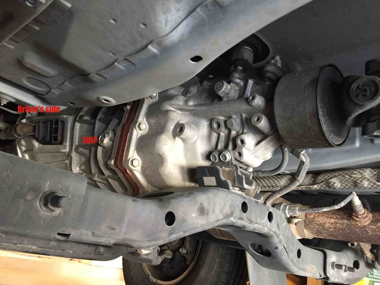

    Got my truck all set in the garage for a 100k MANUAL transmission fluid change but I want to be sure of the location of the drain and fill plug. There are four 24mm bolts under there and I don't want to undo the wrong ones.
    I see one on the lower part of the transmission on the PASSENGER side (drain?) and another one a little higher and closer to the front of the truck on the DRIVER side (fill?). Then there are 2 way up high that are exactly opposite from each other (maybe holding the tranny on to the frame?).
    I assume the first two I mentioned above are what I'm looking for, right?

    Yes, and yes. You are correct for both the drain and the fill plug locations. General wisdom says to loosen the fill plug first, then remov the drain plug.
    It is not necessary to replace the copper washers, just be sure you clean off all surfaces and apply the correct torque when reinstalling the plugs.

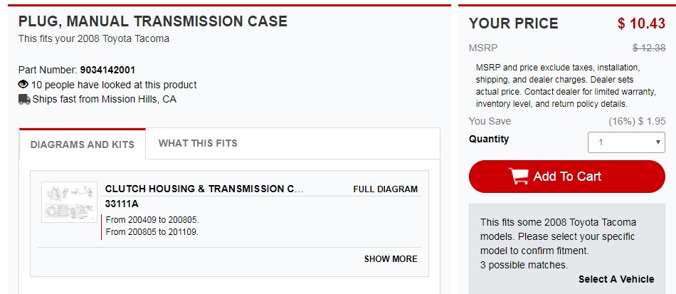

    If the oil plug threads match, you will probably be OK. But if the plug head is not the same then it might leak. Honestly you should replace it with an OEM part, they are cheap. I did a quick search for "toyota tacoma manual transmission fill plug" and found a bunch of stuff, including this:
