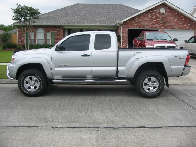

    Here is some pics of mine i have a toytech 3" 5100/Eibachs and top plate. Some pics are 265/70/17 BFG AT's on stock Sport Wheels the others are 265/70/17 Goodyear Authorities on Ultra Rogues. I like the look personally i dont think they look small but thats just me.

    i agree. a 265/70/17 will look right at home on a 2-3" lift. if you get a tire like BFG AT, it will have a more squared sidewall which makes it look bigger compared to other brands/models.
