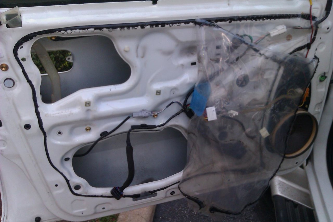

    really? on my 2001 there is one the extends down from the physical lock lever that you can push down to lock or unlock the door manually. the linkage goes inside this shield and prevents use of a slim jim or other theft device to unlock door from outside. it might be kind of hidden between door and window.
    this is a picture of a 4 runner door but the piece in question is in the upper left corner

    phx70[QUOTED][OP] likes this.
