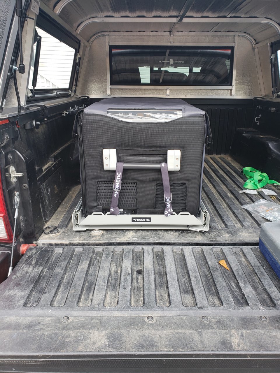

    I have a CFX-65DZ with a cover and the Dometic slide. It's mounted on the passenger side for some weight balance. I've run it pretty hard in the Utah desert and it works great. I pre-cool it before I leave so that it doesn't work so hard to cool down. The freezer side is awesome. Nothing like popsicles on the trail! I run it on the power outlet in the bed but an currently making a 12 volt outlet port in the bed storage door. These things are pricey but once you get one and get used to it. You'll be happy you got one.

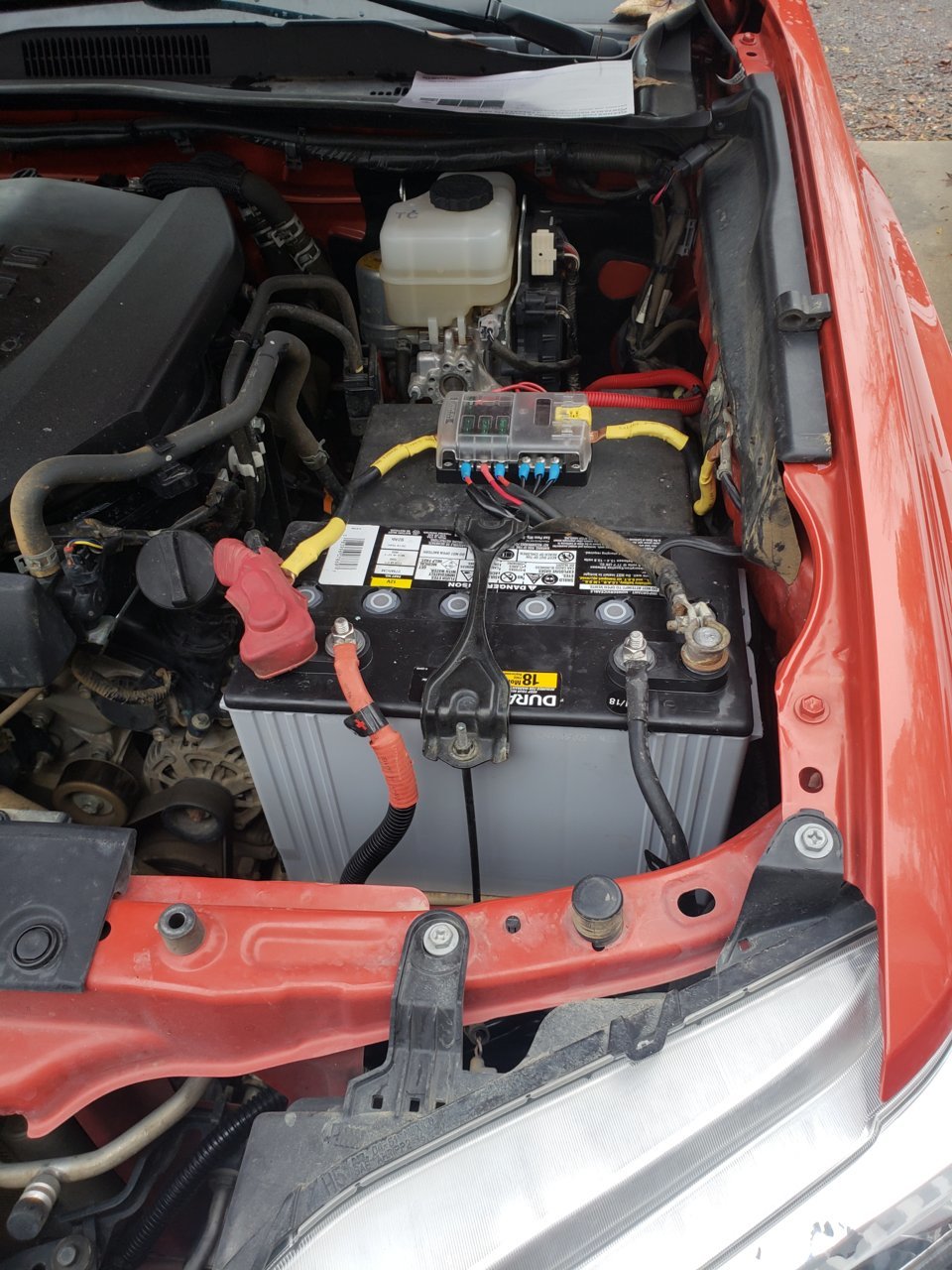

    I ordered a X2 27F battery from batteries plus and a 2nd gen oem tray. I’ve been wanting to do this for a while since my stock battery terminals/post get corroded easily and I plan on adding a dometic, ditch lights, and a light bar.

    I know it is already an older Post and I don't want to insult anyone, but in my opinion when you are about to spend this much money on a dual battery system, then I would go to a smart dual battery system instead of a "simple" relais.
    After a lot of research I pulled last year the trigger on this systems
    CTEK 40-185 SmartPass 120 A Energy Management Unit https://www.amazon.com/dp/B06Y2FMF83/ref=cm_sw_r_cp_apa_i_8Hi-CbREG44A1
    Combined with this one
    CTEK 40-186 D250SA 5-Step, Automatic DUAL 12 V 20 A Battery Charger https://www.amazon.com/dp/B005LBCVL4/ref=cm_sw_r_cp_apa_i_zJi-CbHKNDA0X
    This system will do the following for you.
    1. Integrated solar converter which lets you hook up the panel straight to it
    2. DC to DC tripple charging for aux battery
    3. Battery monitoring for aux battery and automatic disconnect of consumers when getting too low
    4. Back charge from Aux to main battery incase of low voltage for car start
    I know it doesn't come with nice brackets but that's something what can be done DYI.

    If you have the fridge slide, you could use a cable/lock to lock the fridge to the slide.
    Me, I just leave it in my garage until I go on a trip. Then I’ll put it in the bed.

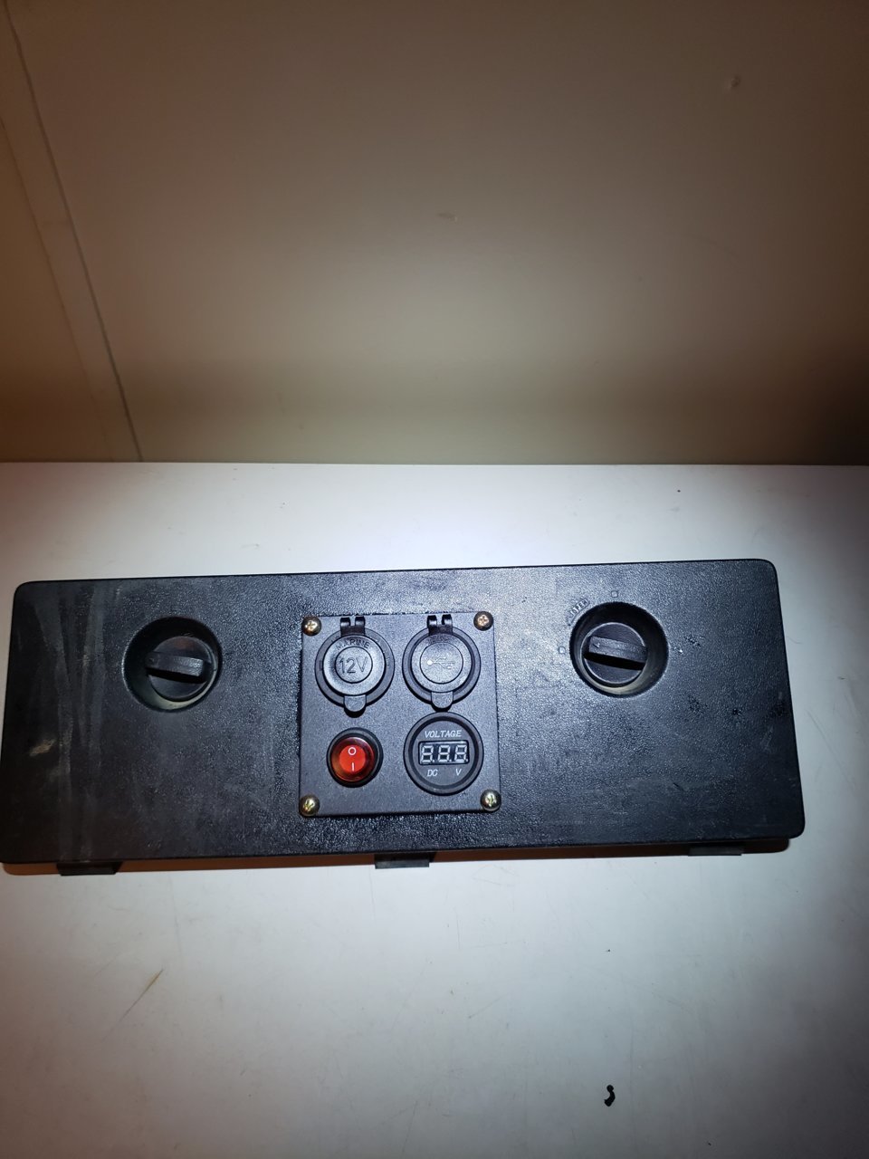

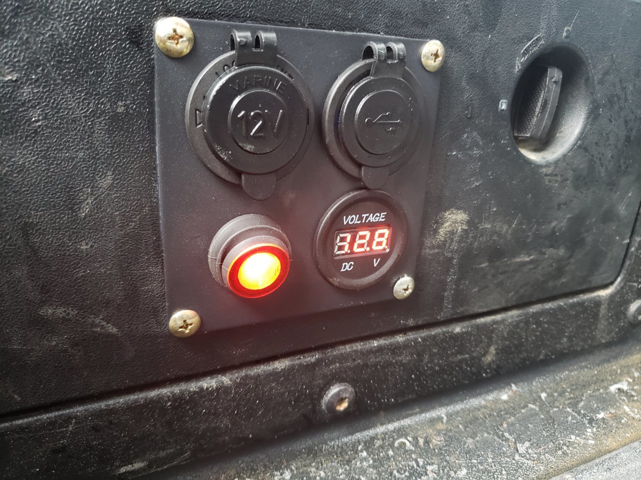

    @tweakit88 how's the inside of that cubby look? Did you drill holes from underneath the bed into the cubby? I have a solar setup and a *portable* dual-battery-in-parallel and need to wire the solar connectors somehow into my camper shell to hook into my charge controller/dual battery box which then powers my fridge.

    I can snap some pics of it for you when i get off work.
