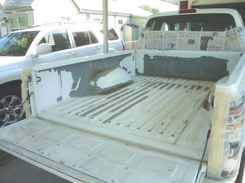

    well here are the before pictures with the 4runner replacement for the taco sitting in back ground

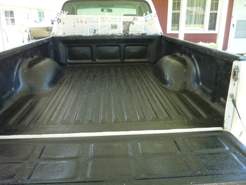

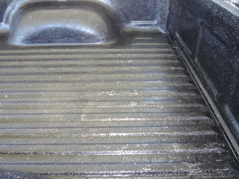

    well first coat is done, this stuff doesn't go on as well as I thought, the sponge roller almost pulls as much liner off as it leaves on, had to dab a few spots with roller to cover up the color. sure hope the second coat covers better or I think I might have to go behind after the second coat is dry and spot dab a few places where color shows through

    my review on this stuff so far is:
    this stuff looks like black oatmeal but it definitely goes on as thin as paint so the spray on stuff is much better (the linex spray in liner in my chevy was a full 1/8" thick) but at 4 times the cost you get what you pay for I guess. for $100, this is plenty good value for what it is but if I had a truck im putting stuff in every day I would say spray on is the way to go, for weekend warriors who just want extra protection and a nice looking bed, this is good stuff.
    also, you seem to get much better coverage dabbing it on with a brush then using the sponge roller and im not seeing much if and texture difference between the two different types of applications
    EDIT - well 5 hours later its dry to the touch but still way too tacky to try another coat, this was out of direct sunlight in 81 degree temps all day. will do second "final" coat tomorrow
