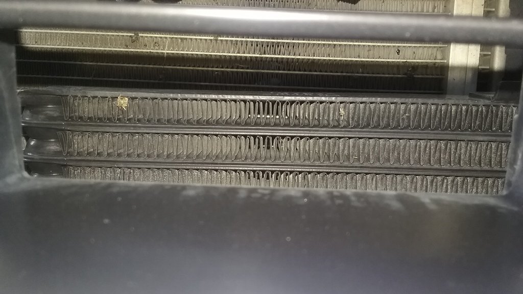

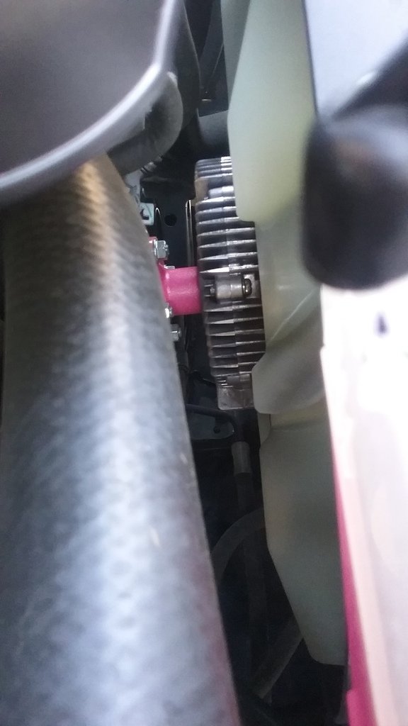

    Pink fan clutch and trans cooler sitting in front of the a/c condenser....looks like a small radiator. Also, there will be 2 lines coming from the the collar around the oil filter base.
    All these indicate the OEM tow pac.

  13. Nov 17, 2016 at 1:22 PM
    Plain Jane Taco
    Plain Jane Taco Well-Known Member
    Apr 19, 2009
    #16179
    40,279
    USA
  14. Nov 17, 2016 at 1:29 PM
    Plain Jane Taco
    Apr 19, 2009
    #16179
    40,279
    USA
  15. Nov 17, 2016 at 1:31 PM
    Plain Jane Taco
    Apr 19, 2009
    #16179
    40,279
    USA
    Looking through driver's side of the grill

    Plain jane pics ftw. Pop the hood and look for oil advtrans coolers as shown above
