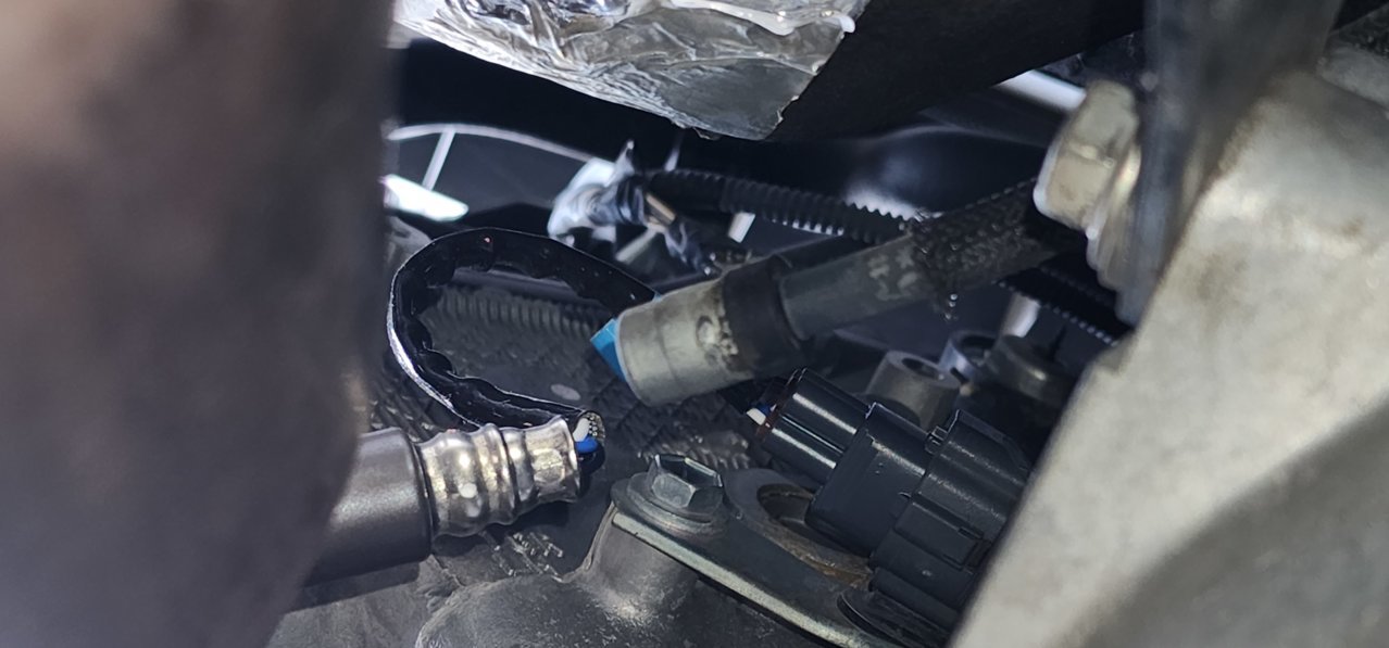

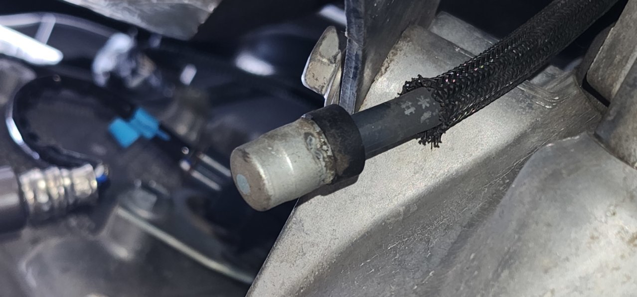

    ODB shows a DTC P0157 "Oxygen Sensor Circuit Low Voltage (Bank 2 Sensor 2)" I replaced the O2 sensor. Didn't help. While inspecting near Sensor 2, I find a wire bundle going to a metal cylinder that's just hanging there and it appears that the cylinder part is pulling off from the small wire bundle. Any ideas what this is? And could it be the problem?

    That looks like one of the breather hoses for either a diff, t case or transmission.
