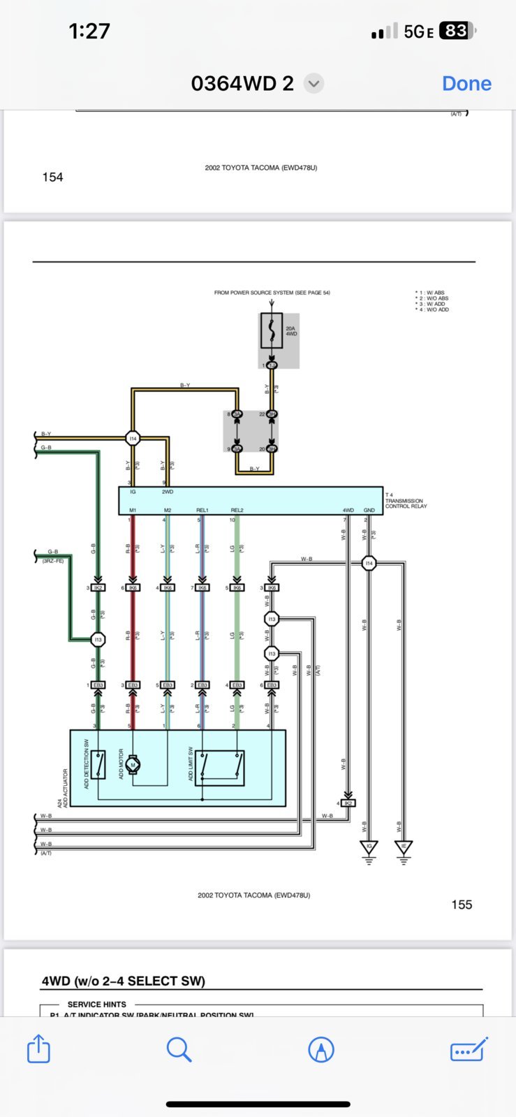

    Hello, I see you used the trans relay on a prerunner, im doing the same for my 04 j-shift with a.d.d. Which pins did you use for power, and landing on the actuator?ECF3D342-95F9-4024-B693-A3AF2FABDC8B.jpg

    You may have meant to quote the OP of this thread, I believe he was the one doing the 4x4 swap. I'm sure Mr Pool could answer your question, although I'd be surprised if he swapped his truck from 2WD to 4WD.
    The info you need is on the wiring diagram you posted on the other thread, as well as the picture of the relay connector pin numbering above. Power to the relay is via a switchable ignition source to pin 3, which is junctioned with the lead from pin 9 and goes to the positive lead on the 4wd position switch on the transfer case.
    For the ADD actuator, you just need to ensure that the leads/pins match the diagram below, i.e. pin 1 on the control relay matches with pin 5 on the actuator connector, etc.
    Re-posting the pin/lead identification for the transmission control relay here for completeness (wire colors are from the factor harness, and match the colors in the EWD above):
    Transmission Control Relay pins:
    1 - ADD motor (red-black)
    2 - Ground (white-black)
    3 - Ignition power (black-yellow)
    4 - ADD motor (blue-yellow)
    5 - ADD limit switch (blue-red)
    7 - Ground from transfer 4wd position switch (white-black)
    9 - Power from transfer 4wd position switch (black-yellow) (junction with pin 3)
    10 - ADD limit switch (light green)
