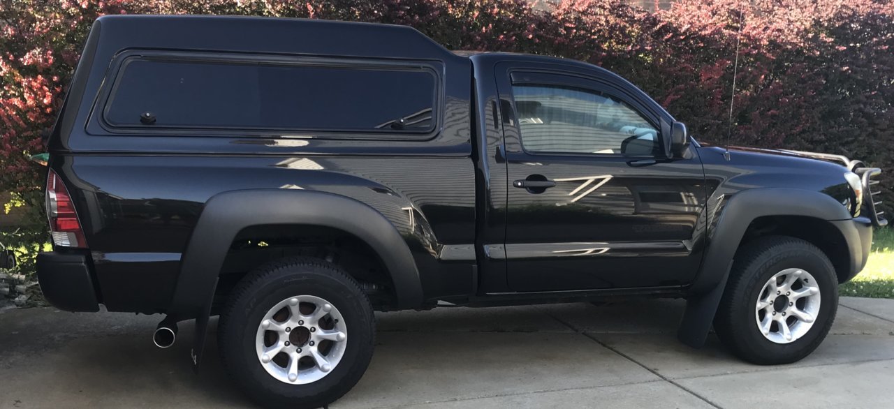

    Finally bought stock size p 245/75/16 Mastercraft Stratus AP for my 98% of driving. I know it doesn’t sound very exciting but rides nice and I figure I save about $20 in fuel every 3 weeks. I have BFG commercial T/A for Winter 5D7AB1D1-2979-4B23-BCBD-B5BAB277D01D.jpg
