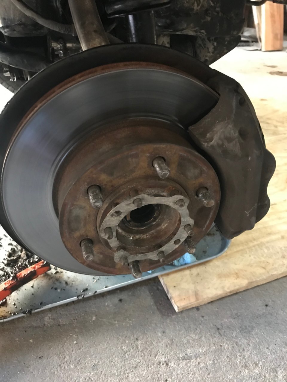

    We recently bought a 1999 Tacoma SR5 for work and fun out in the country. We can't get it to go into 4WD (well it's missing a front axle right now so ... 3WD).
    It doesn't actually have manual locking hubs ON IT, but it does have the studs for them. If it was missing an axle I am wondering if the hubs were removed also and just left off as well.
    How would I know if I SHOULD have manual locking hubs or if it is equipped with ADD. IS there a difference in the wheel hub or the shifter?

    I'm not sure how to lock the hubs with ADD, so not sure if there is a light or button on the dash.
    Take a picture of the front differential tube.
    Look at my 4WD conversion thread in my signature.
    I show you the ADD dif tube (has an actuator that locks cv to diff) versus the non add diff tube.
    Also in your second picture I don't see the CV.

    If it has ADD there are no hubs just drive plates

    frenchee - I think you hit the nail on the head. We definitely don't have the ADD Diff tube.

    Also, I don't know the difference, but there is a difference with the manual CV shaft and ADD CV shaft.
    If you order a replacement, get the right one. I got one at Autozone and it specifically said manual hub CV shaft.

    Post a pic of the end of the axle shaft that is still in place.
    ADD and manual hub shafts are different

    Picture attached. Ordering the parts and seeing the different descriptions was what got me thinking something might be off. He said order the auto version, so I ordered the auto version, and now I get to return ... you guessed it ... the auto version! (Well, I'm going to wait to see if you guys agree based on the picture)

    That is indeed a manual hub CV

    Perhaps but OPs truck appears to have been swapped by the previous owner
