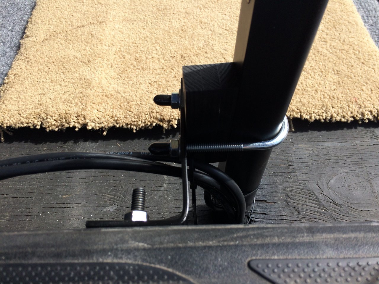

    image.jpg Got a good start on a topper lift for my 05 Tacoma. I used 4 16" linear actuators that I got from windy nation. They are suppose to be good for 225 lbs lift each, and only draw 2.5 amps per actuator . So far only have about $250 in parts.

    It'll be a while before I get a tent skirt made up, but I have the lift done. I added a blue sea fuse block to feed power to the linear actuators.Installed the switch in the tailgate pillar and all wiring is done in the behind the driver side tail light. Included are couple of pictures to show the brackets I used.image.jpgimage.jpgimage.jpgimage.jpgimage.jpgimage.jpg
