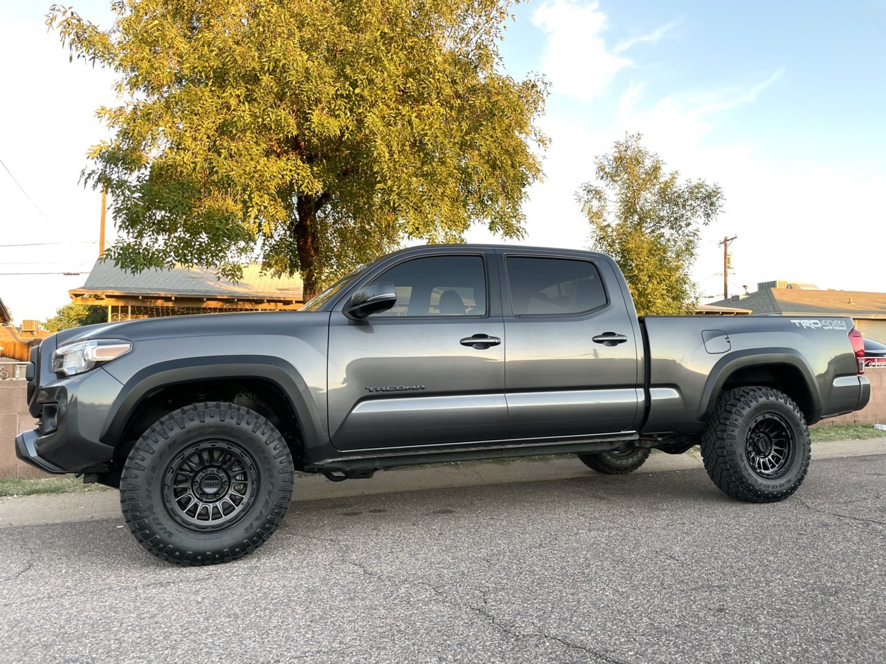

    Hey fellas!
    After putting money aside, window shopping, reading through this forum and FB groups, countless YT videos and identifying my needs, I finally purchased suspension components. I’m wanting to install everything myself and am hoping you guys can help me with some info.
    I will be installing:
    - Camburg X Joint UCA
    - FOX 2.5 IFP Coilovers
    - FOX 2.0 RR Rear Shocks
    - ICON RXT Leaf Pack
    My questions are:
    1: What are the torque specs?
    2: What kind of jack and jack stands will I need?
    3: Will any grease gun and grease work? Any suggestions?
    4: What is the tool list? What size wrenches, sockets, breaker bar, etc?
    5. Best way to remove existing leaf pack?
    6. If you had one tip, what would it be?
    I’m a carpenter by trade so have accumulated a lot of tools naturally but not one metric wrench or “mechanics tool”. I’d like to take this as an opportunity to learn and build my collection of tools.
