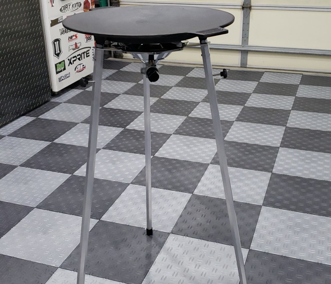

    I have always wanted a Skottle for cooking but they are spendy. I built this for about $120.00. Attached is the BOM for those who might want to make there own.

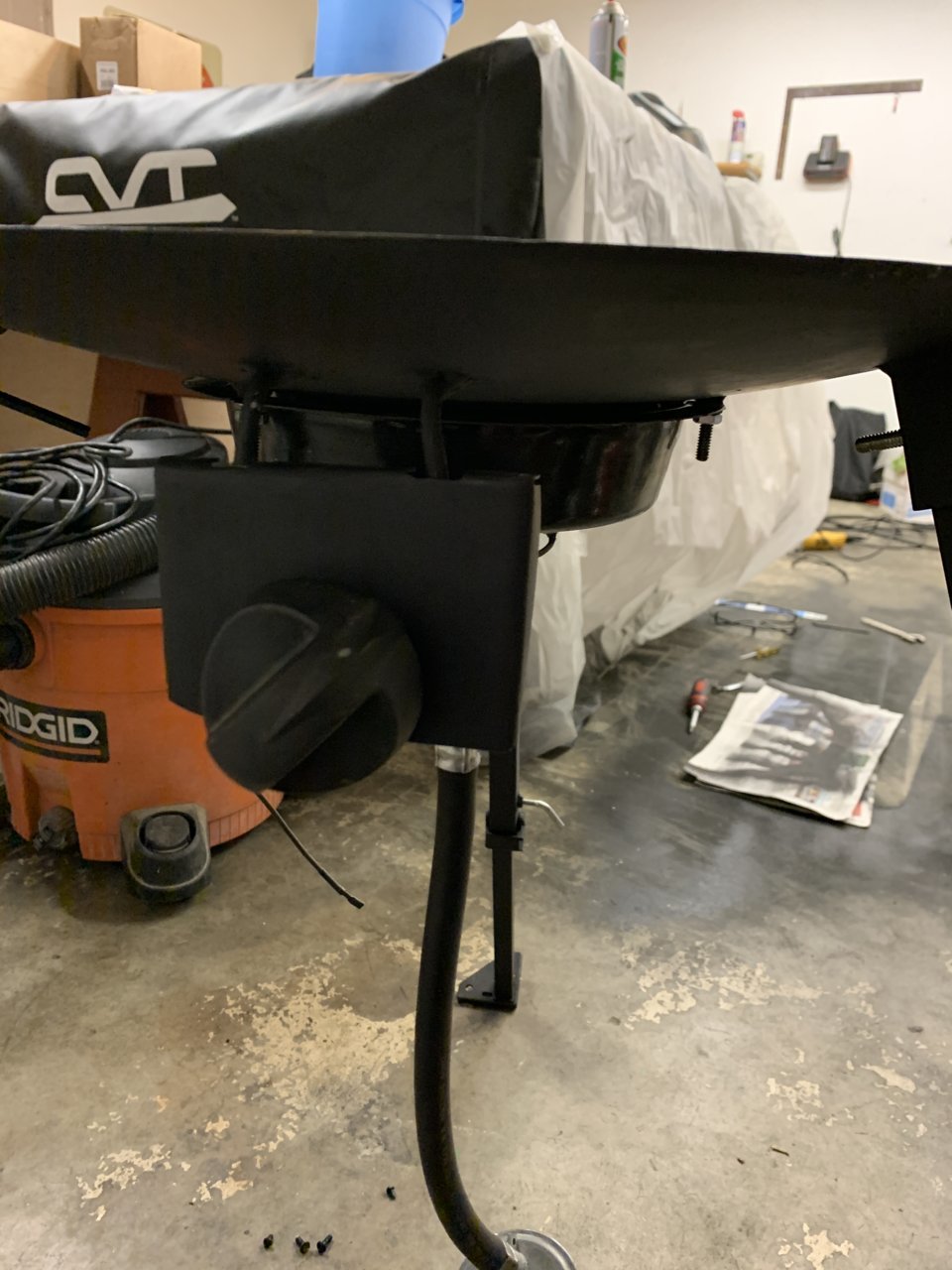

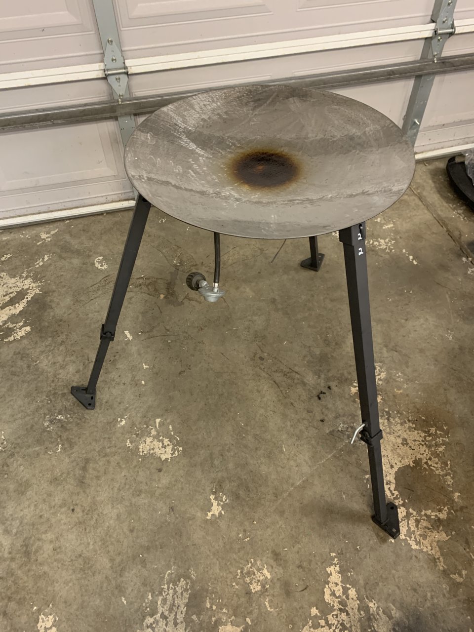

    Here is my DIY Skottle: gf’s father is a farmer so I was able to get a used disk, spent a few hours grinding off the coating, used a sanding disk to clean it up and get it smooth. Pop up tent that someone broke supplied the legs, they are 20” each piece so I can adjust from 21” height to 38” height. I painted them in a high temp black paint along with the underside of the skottle. Burner setup is from a grill which my buddy had laying in his garage. I need a fitting that will allow me to go from large propane bottle to small green propane bottle. Total cost was ~ $25.00

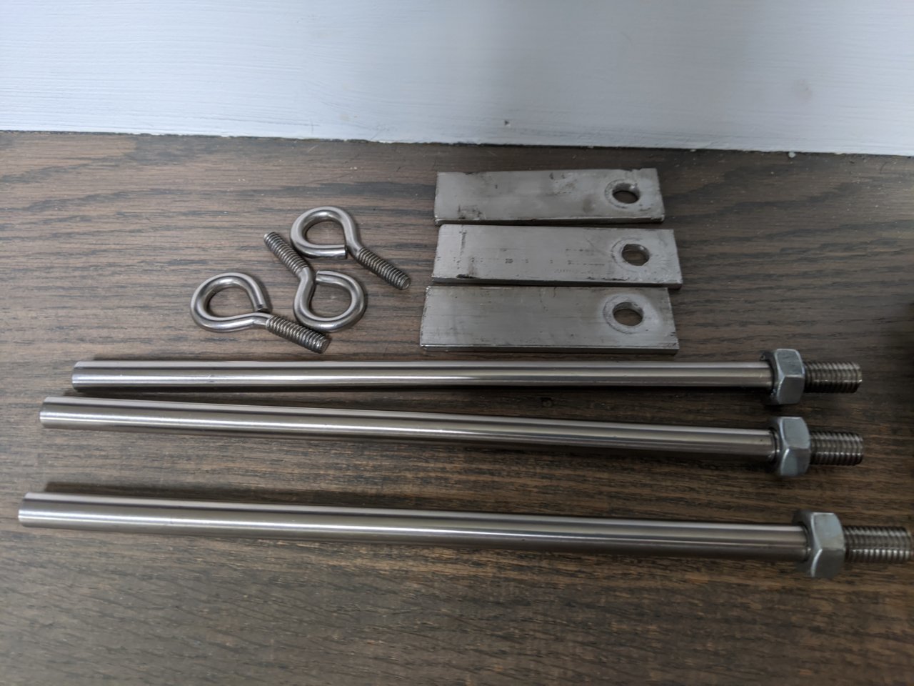

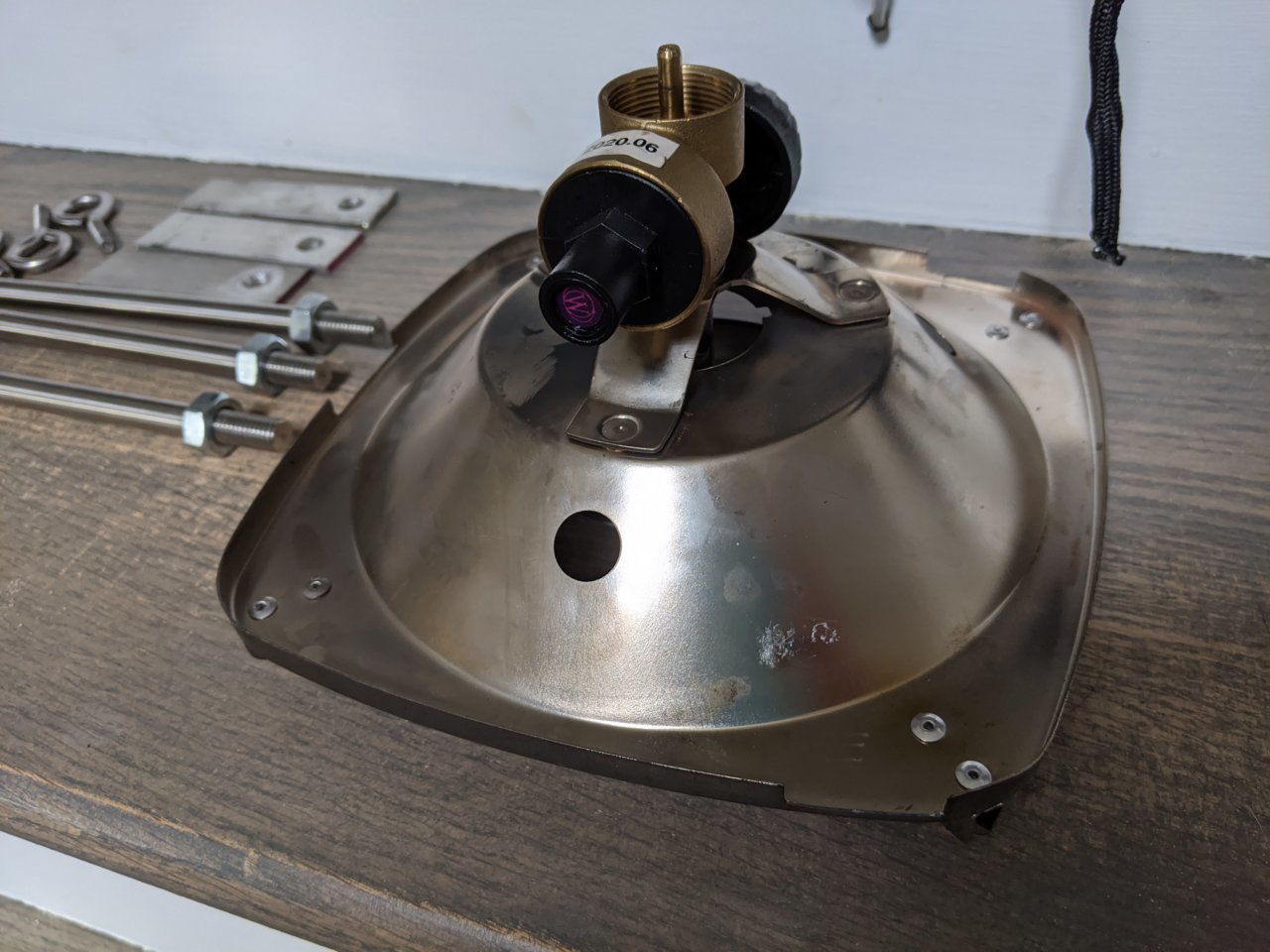

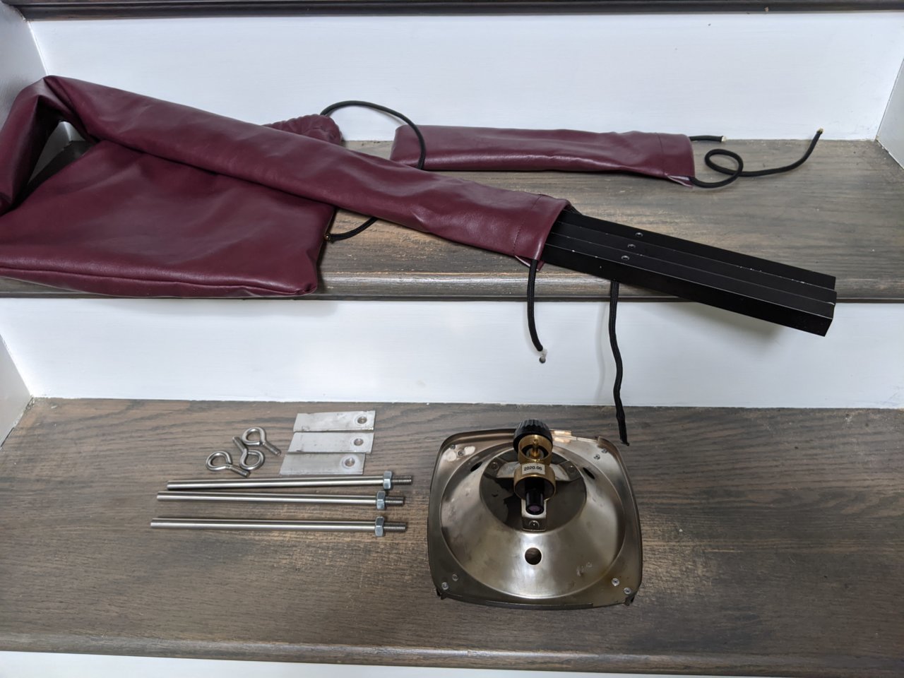

    I have attached pictures of my parts disassembled. As you can see it's rough. I don't have alot of good metal working tools. I used a reciprocating saw to do the aluminum cuts, a hand drill to do the holes, and a dremel to cut tabs in the ozark trail gas burner. This thing impresses everyone I show it to because all the shitty cuts are under the hot part and not exposed.
    I also went to Walmart and bought pleather to make the bags. I am super happy with this project.
    Happy hunting.
    E: this setup only works with the bayou classic, due to the three threaded holes on the bottom.
