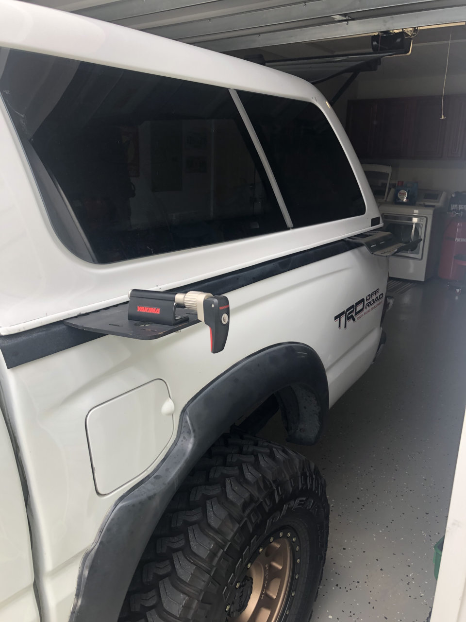

    I have a VooDoo mount if you’re interested. It was great when it was just me riding but now I have a family of four so I’ve switched to a tailgate pad. I did have to modify the holes a good bit to get it to work with the first gen though. I used Unistrut from Home Depot as my bed rails and then mounted the voodoo mount to the Unistrut.

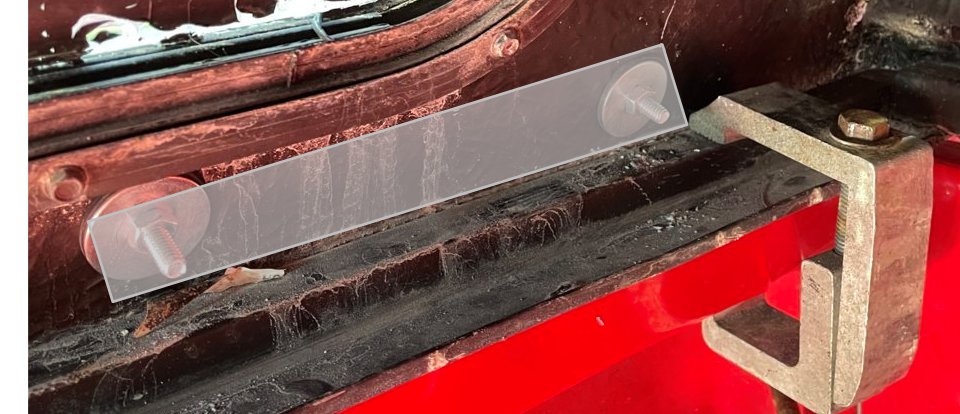

    So I decided to try a full DIY approach. $60 of hardware and a few hours later I have this. Seems to hold the bike well so I'm gonna experiment with some tie downs for travel! The inside pedal sits just on top of the shell which worked out great.

    I'd suggest a piece of flat stock between these two bolts since that left one is pretty close to the window cutout. You shell might crack.

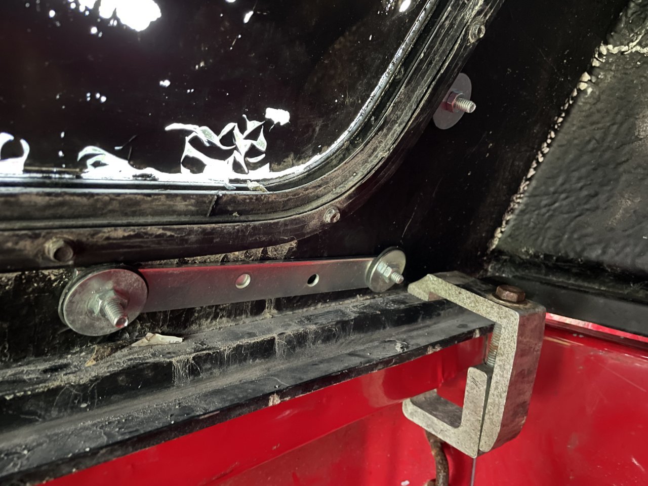

    Hey thank you very much for the recommendation! I'll definitely do that before any more testing.

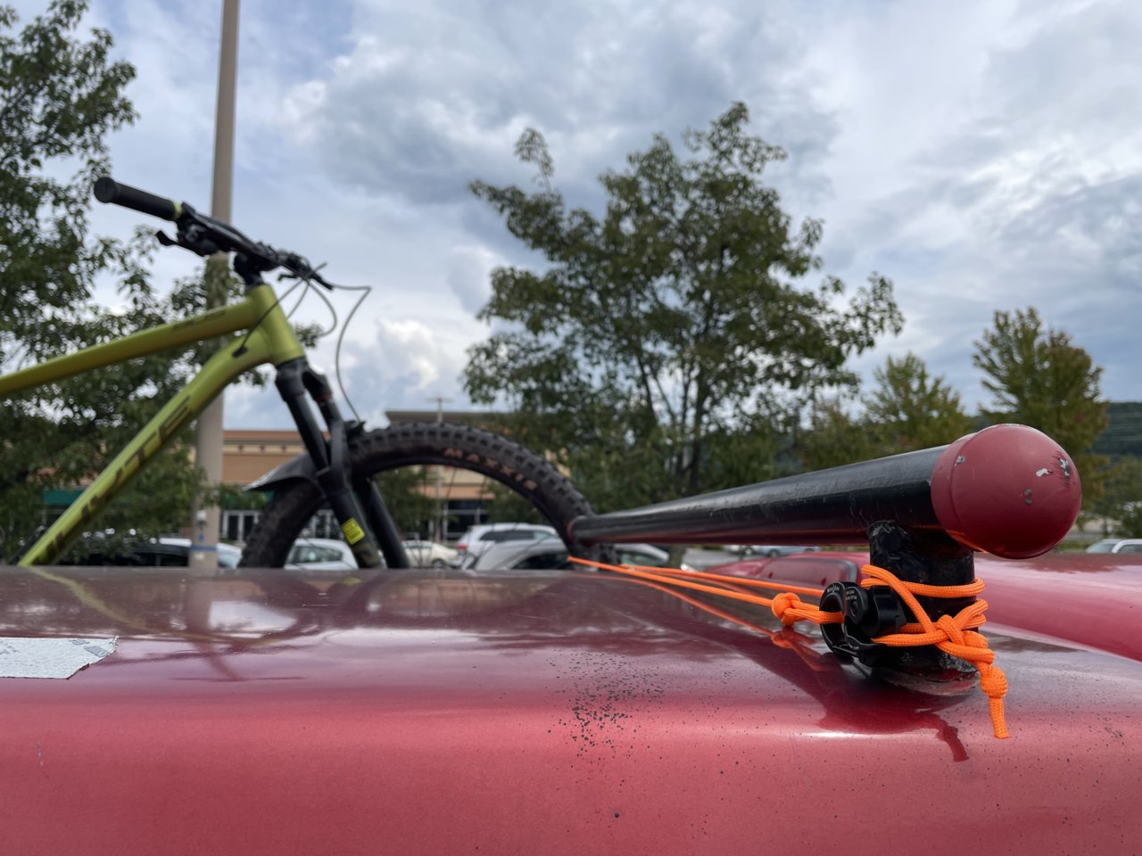

    I reinforced both sets of lower bolts and added velcro straps and tie downs. Multiple hours on the highway with no issues or movement!
