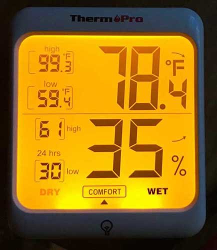

    I also measured the temperature inside the cab as follows:
    1) three consecutive days without the side and rear shades (just the windshield shade) and the max temperature recorded was 99.3 degrees Fahrenheit
    2) three consecutive days with the side and rear shades (along with the windshield shade) and the max temperature recorded was 97.2 degrees Fahrenheit
    So it looks that the shade helps a little bit in terms of lowering the internal cab temperature.
