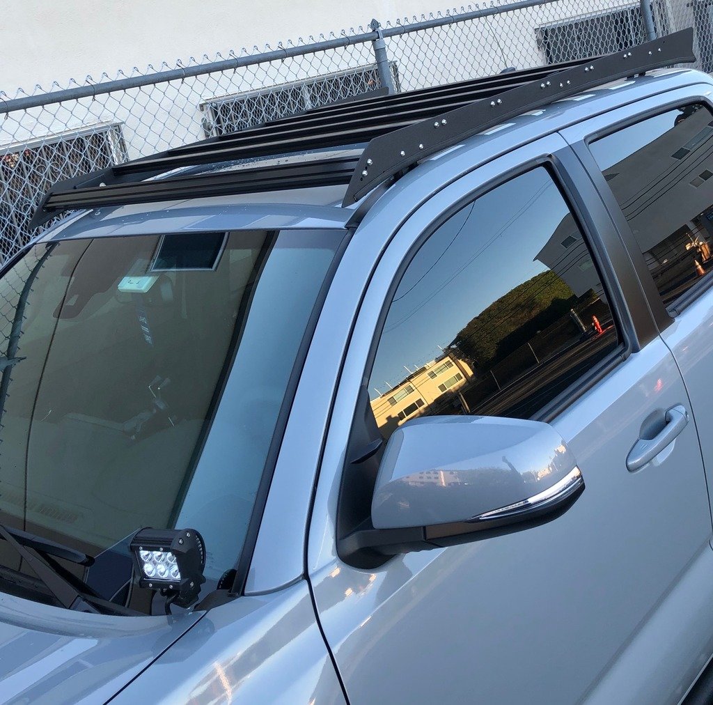

    I made one too for my 3rd gen. If I can figure out a way to mount one on my 1st gen, I'd do the same. IMG-0623_zpskchyk674.jpg
