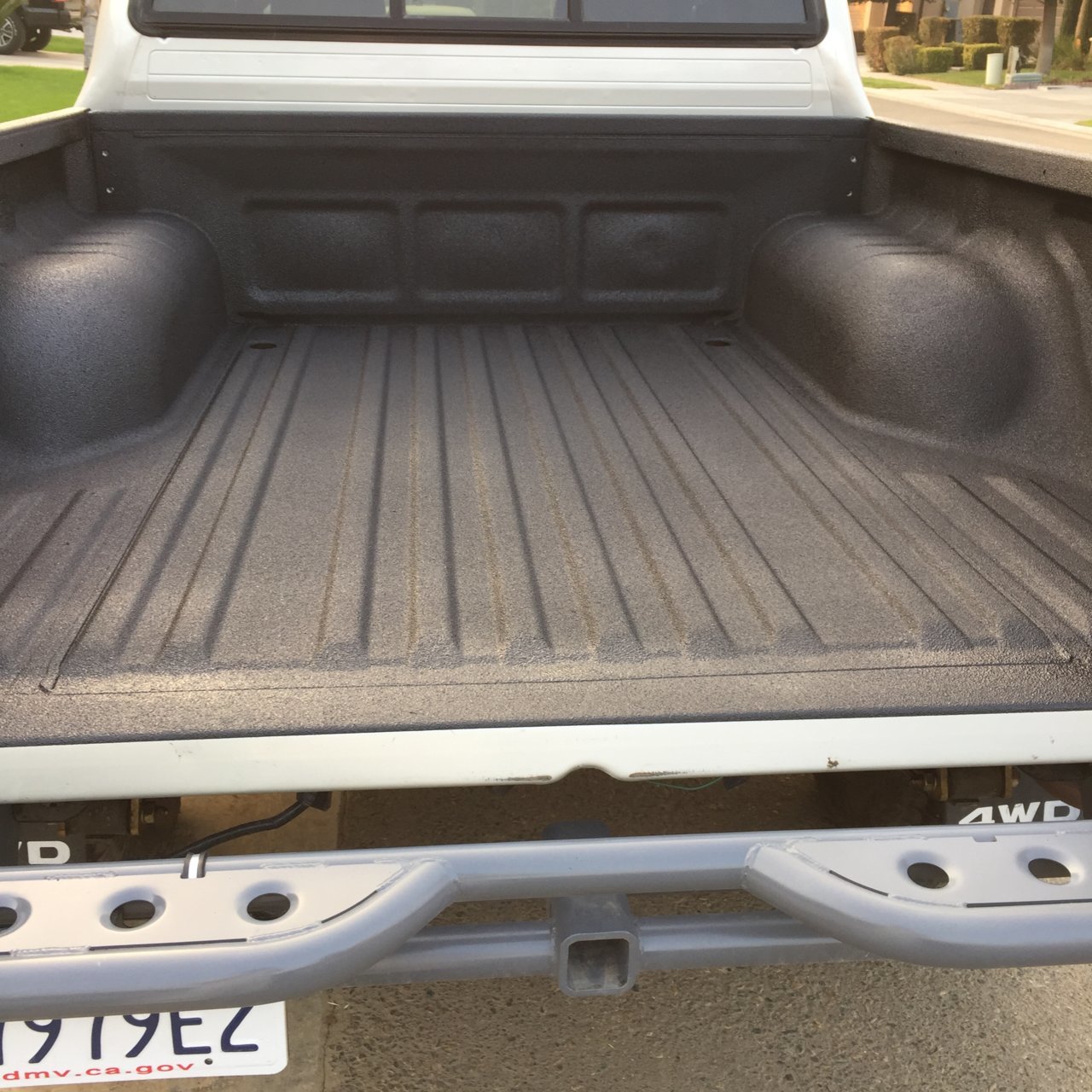

    Here is a DIY on the Raptor Liner I did on my truck. Excuse grammar and spelling. I will update for corrections. I had an OEM bed liner in my truck bed for I don't know how long. When I took it off there was of course wood chips, dirt, mud etc underneath. Before I did Raptor I did research on Line X and was really considering it. For my truck (DC) It would of been $450, extra $100 for over the rail, another $100 for UV protection for a total of $650. I got the Raptor (4 Liters) kit w/gun for about $108. It is also UV protected. Supplies which cost me another $70-$80. The extra cost will be dependent on what you already have. The coating is for sure not as thick as Line X. How durable will Raptor be, only time will tell.
    You will need:
    120-180 grit sandpaper
    Masking tape
    Paper and or plastic drape
    Raptor Kit
    UPol Acid 8 primer
    Degreaser and dish soap
    Air compressor
    Dusk/paint respirator w/particle filter
    Googles
    Blue shop towels
    Optional:
    Orbital Sander
    Primer
    Disposal Coverall w/hood
    Platform/table/stand
    Screw driver
    Socket wrench
    Acetone
    Rubbing alcohol
    Shop rags

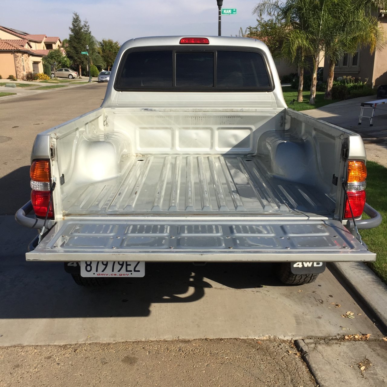

    First day I used Simple green to degrease my truck bed and rinsed. My bed was for the most part was already cleaned and there was no grease on it. Once it dried I masked my edges since I was going over and down about half an inch on the rails. If you are just going over the rail there is no need to mask at this time.
    I highly recommend you wear your paint respirator, googles, and disposable overalls. I used an orbital sander with 120 grit on the easy to reach and large surface. I also tried a die grinder, but it was too much and ate through my paint. I tried difference pads and psi but wasn't worth it. Most of your sanding will be done by hand to get in all the creases. Our trucks has a lot of creases. This part took the longest since I was detail about sanding every inch of the bed the best I can. I used 150 grit sandpaper. I recommend the 3M brand sandpaper. It has better backing and is more flexible which will help you get into corners and creases. Harbor Freight sandpaper is not worth it. Use the compress air to blow away the small particles to give you an idea where you need to sand more, also helps keep your sand paper from getting clogged. I have a 21gal Harbor Freight compressor and it worked fine. Never had to wait for it since I was only using 50 psi. When I thought I was done I rinsed the bed and dried to see what areas needed more work. Took note and was done for the day.
    Second day I did some touch up sanding on areas that needed attention. Once I was done I washed my bed with dish soap, rinsed, and dried. While I was waiting for my bed to completely dry. I took off my tailgate and I recommend you do this to make it easier later on. Remove your tie down anchors. Roll up masking tape and insert them into the screw holes. I also took off the screws on my tailgate mechanism cover.
    Now for the masking. This part also took some time since I wanted to make sure I got all the edges sealed and covered most of my trucked. I was doing this outside so I didn't want any overspray. I use pre-tape masking film, 2 inch blue 3m masking tape, and 1 inch green masking tape. The 1 inch masking tape helps you getting better lines when masking your bed rails. Once your truck bed is prepped and cleaned you do not want to put your dirty shoes in it. Put a paper drape down in the bed so you can temporary stand inside to mask off the back of your truck.
    Once you feel that you have masked off your truck properly start with the Acid 8 primer. Cover all expose metal. How much Acid 8 primer will depend on the condition of your bed, 2 cans for me. After the Acid 8 primer I used Rust oleum primer, 1 can, I forgot which one it was. The Rust oleum primer is optional. I waited 20 minutes before I started the Raptor spray. The Raptor overspray is very sticky and will leave stains. I don't know how permanent the stains will be so I would suggest you cover the area you are working on if you don't want it all over your floors.
    When spraying on the Raptor, mix two bottles at a time. You have 4 bottles, 2 bottles per coat. I used an extra protein scooper that was exactly 250ml measure the hardener, this step is also optional. I sprayed at 50psi. The first bottle will leave a very light coat, it will start to fill as you use more bottles. I used two platform benches on each side to give me a higher working area so I can better spray inside the truck bed. Spray the whole bed/tailgate with one bottle at a time. Spray as much as you can with the bottle upright. This will help it not spill out from the top hole on the gun when you need to tilt the gun for certain areas. I didn't and couldn't go under my bed rails but I did go as high under as I can. Once you are done with the first two bottles, first coat, clean your gun. I pour some acetone in of the used Raptor bottles and sprayed it clean. Then I wiped it down with more acetone. Now let it dry for about an hour, per the direction.
    Second coat is the same as the first coat, mix both bottles at the same time. Spray the entire bed one bottle at a time. By your third bottle your truck bed should look evenly coated. The fourth and last bottle you would go over any spots you feel should require more liner. For me it was the top rails, sides, and corners. I figure if I needed to touch it up in the future the open spots would be more easy to spray and not much masking would be required if any.
    Once your done spraying your final coat start cleaning up. About 15-20 minutes, which comes pretty quick, start to remove your masking tape. Optional, I used a damp shop towel soaked in rubbing alcohol to go over my edges once I took off the masking tape. The rubbing alcohol helps the towel not stick to your fresh liner. Use rubbing alcohol to wipe away any stains on your truck cause by removing the masking tape/drape.
    The longest part of this project was sanding and masking. The actual Raptor spray part goes by quick. If anything I wish I would of got 6 bottles instead of 4 to make it 3 coats which UPol recommends not to go over 3 coats. I would think if it was thicker it would be more durable and maybe help it last longer. This could be done in one full day if you start very early to give you enough day light. I took my time because this is my hobby truck that I take on certain trips and only drive maybe once a week to keep the battery from dying. I'm going to let the Raptor liner cure for 7 days before I put anything inside the bed. This way I can eliminate all possible reason for it not to last or be durable as the company claims.
