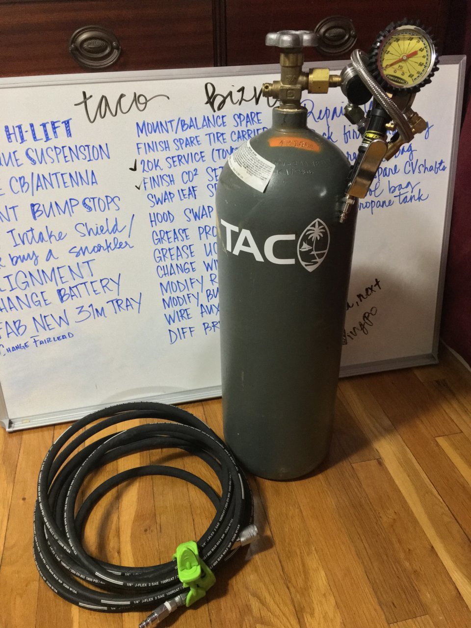

    Just finished this one up today.

    Details please!!!
    Where did you get the hose?

    The hose was just kinda sitting around at work. But you could get away with a 3/8 Hybrid hose from harbor freight for less than $20. Regulator is adjustable, so I can use my impact gun, but if that’s not a need, you can get a fixed non-adjustable regulator for less than $30. Anything else? Feel free to ask

    I like the idea of not having to wait! Do you have a set up Similar to this? If so, have you had any problems with it?

    Haven’t sorted out the mounting solution yet, but looking in using a Anerex 20lb fire extinguisher mout, or just go the cheap route and use those super cool quick fists and strap them to my rack. The tank I found local for $20 empty and out of date for the last hydro test, but was able to do a 1 for 1 exchange via my local Amerigas for $39 I believe.
    This is the tank mount I was talking about These are the Super Quick Fist Clamp I’m also looking into.
