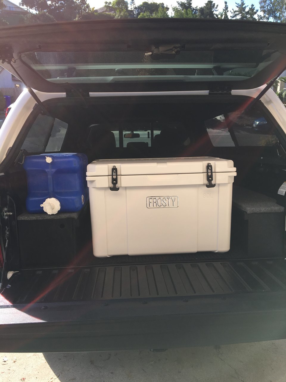

    Hey guys,
    I have been reading TW non stop for a few months and learning a ton. I thought I would share some ideas for people. I read a bunch of threads on sleeping platforms and bed storage to get ideas. Combined with the fact that in high school I worked at a camper shell lot I always liked the carpet kits people out in.
    I had a single level platform in my old Tundra, the drawback was it was not easy to take out and only had one easily removable piece.
    I had specific demands for this build. I wanted a sleep platform, easily removable and underneath storage. Inside the shell would be used for camping and city life. I do a lot of spear fishing and guns with shafts get long, hence the long bed and the underneath storage.

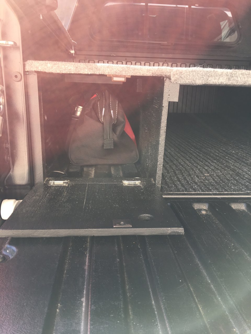

    The carpet kit I designed off the old school kit and other peoples builds meets all me needs. First off I made the two side compartments different widths. I wanted one that would extend the length of the bed and clear the wheel well. It has a pull down hatch at the front. On the other side I put an inner hatch to access the storage and inverter plug. On the top of both compartments are two top side hatches to access the storage. The middle section was divided into theee pieces. As you will see in the pics I designed the measurements to fit my cooler and water source. We often hike in between camping spots and eat lunch right on the tailgate. Food and water need to be easily and readily accessible with two kids. The cooler fits perfectly into the first removable section of the bed allowing for maximum storage space of gear.
    The entire unit can be taken out and installed by one person in less than two minutes and is light. Occasionally I still need a truck as a truck... to haul shit. 2056DB23-EE18-42DF-9252-FE335D0DC19A.jpg4261A922-72B0-4EF1-9DA8-1853F8450536.jpg 2056DB23-EE18-42DF-9252-FE335D0DC19A.jpg 0410F339-7109-4280-85D3-453EAA09F702.jpg262A78B9-D394-4645-9A67-E228F4E1A01B.jpg 22D24B80-0113-4F6C-8601-6588A357ADE7.jpg F7A91F52-C515-4ECF-A338-40F3CAA783D9.jpg

    Sorry, I did now write down the measurements, I have a long bed too so they would be long. For the sides you can customize your own width.
    Borrow a jig saw for the back corners near the tailgate.

    Thanks guys.
    I have to say I’m really loving it. I had to go pick up a load of mulch from the landfill over the weekend. Literally took me less than 2 minutes to take it out and less than two minutes to get back in. I pick up the mulch in plastic trash cans, I can fit 6 in the back. Load them and just slide them in. Unload at home.I just vacuumed out the inside and I was done.

    Two sided boxes with an end cap. There was the top the vertical piece and the end caps shown in photos.
    The top piece fit flush on top of the lip in the bed liner. The vertical piece was measured and cut so that it fit in the rib of the bottom of the bed liner, same was done up front. The entire unit kind of snapped or popped into perfect place. I never had the need to “tie” it down off-road or not. It stayed in place perfectly.

    $100 ish. Plywood, wood glue, had the nail gun, some hardware, carpet and a couple of rattle cans. I had primer which I threw down first too.

    535
    Eric
    San Diego
    2017 White Tacoma DCLB TRD OR
    I used 1/4 for side walls and the stuff that is just under 1/2” for top pieces, I forget the actual size- all from Home Depot. The 1/4” was plenty strong and kept it really light.
