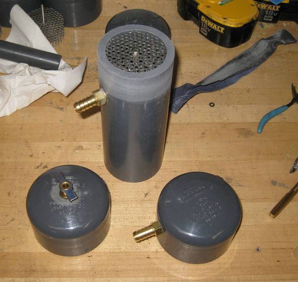

    Parts list:
    2.5" PVC piping
    2.5" PVC caps
    Metal mesh (stamped in to 2 1/4" circles)
    8/32" ss screws, spacers and nuts
    1/2 - 13 Tap
    27/64 (size) drill bit
    1/4" drain cock
    3/8" hose barb x 1/4" NPT
    1/4" 90 elbow
    PVC primer and glue
    sand paper

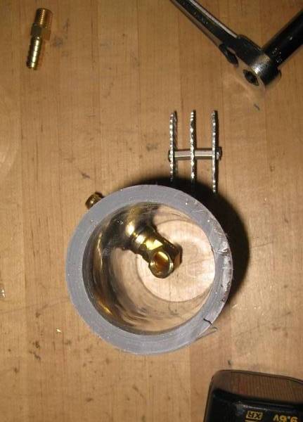

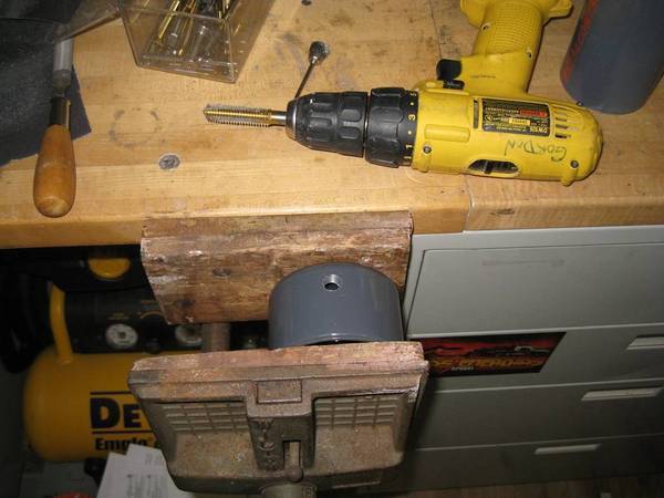

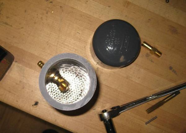

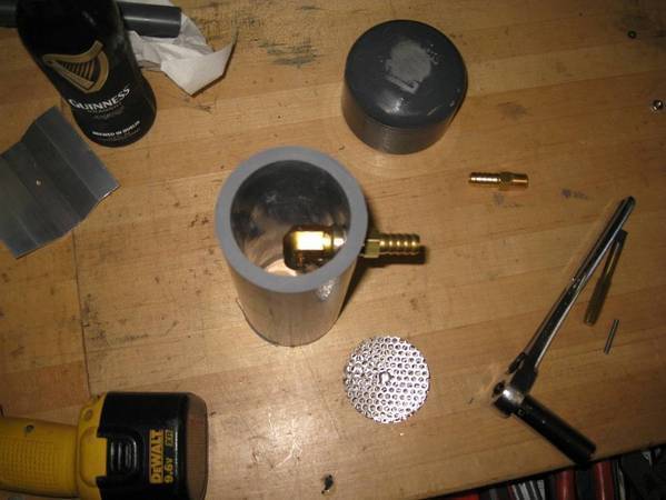

    I used a bench top drill press to drill all the holes (27/64 drill bit) and tapped with a 1/2-13 tap (drill set to lowest speed).
    Installed barb connector and a modified 1/4" elbow
    The elbow was ground down removing about half of the threads. I cut off the extra lenth of the screw and hammered the cut end to mushroom it (to keep the nut from coming loose).
    On the output side of the elbow I ground it to a 45 and opened it up a bit.

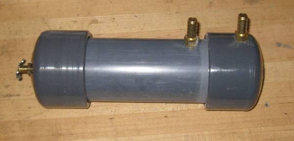

    The mesh circles were forced in and will not move. Sanded, cleaned and ready for assembly.
    Primed, glued and ready to install. Ended up being about 9 1/2" tall

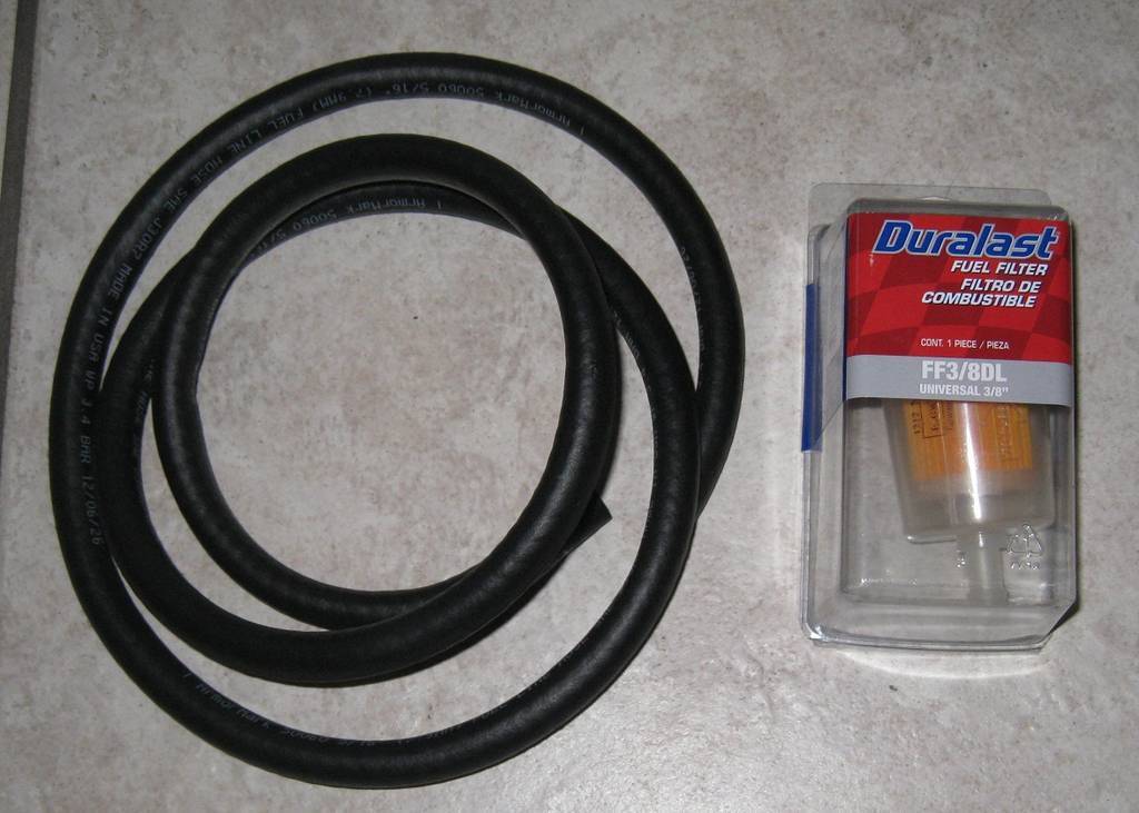

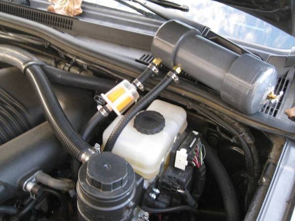

    Stopped by auto zone and picked up 4' 3/8"ID file line and a 3/8" fuel filter.
    I used (2) 2' lengths of hose, leaving enough slack to pull it out to drain.

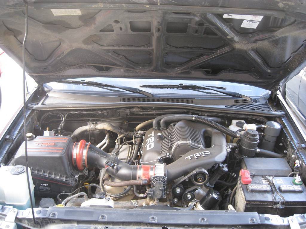

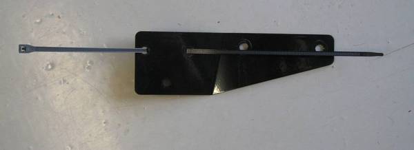

    Left over bracket from the supercharger
    Ran out of time, zip tie is temporary.

    I haven't drained the can yet but did inspect the filter and found a drop of oil that tried to sneak by, otherwise it looks clean. The 3/8" fuel filter was only $4.00 so I think I will replace it every other oil change.

    Made one very simular to your design. then touched it up with some nice magnetic gray spray paint. after only 20 miles i opened mine up to find a drop of oil already sitting on the bottom!

    thanks. i picked it up from the hardware store for around two dollars. also used the stock hole in the firewall. found a bolt with the right threads and it works out very well

    I like the idea of the fuel filter on the outlet. A concern that I have with the DIY PVC cans is that the vibration of the truck can cause the baffle material to abrade the PVC and allow it to pass into the outlet... the fuel filter will catch that, will last for a long time (I'd change it with the air filter at 30k), and they're dirt cheap.
