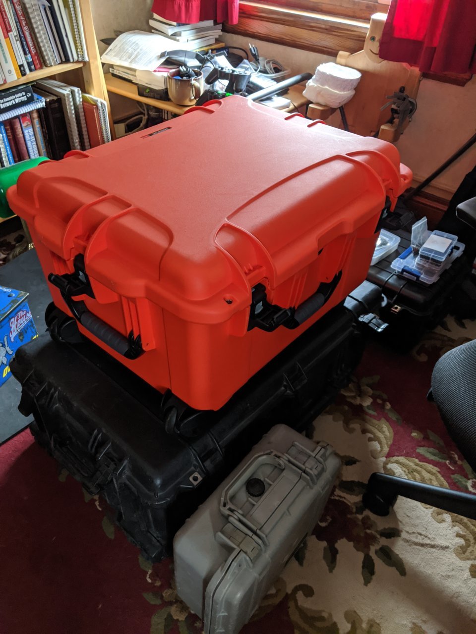

    I have never seen the Nanuk case before either. I have a habit of trying to buy cheap pelican cases whenever I can. I scored a Pelican 1650 for $50 once, and I have been looking for something of similar size for awhile now. There is an auction site that sells returned items. I refer to it as the garbage auction site. The wife hates that I buy stuff from there, but I have scored some insane deals, but I have also been burned by picking up complete garbage. You end up buying things sight unseen, with no returns. So, it is a risk you have to be willing to take. The sellers will post a couple of pictures, and you have to figure out how much you are willing to gamble on the item.
    The Nanuk 960 was picked up for $70. The plastic is a tad thinner than a Pelican, but it has some other things going for it that Pelican could learn from. The handles are much nicer, the latches lock into place (more moving parts, so we will see if durability is the same, but I don't beat the hell out of my boxes right now).
    I am still working on dividers for the main part of the case. I am 3D printing corner brackets and T brackets for the dividers, and then I am going to use some acrylic sheets (also picked up from the garbage auction site for very little).
    Inside of case (with incomplete dividers):
    Nanuk 960 on top of Pelican 1650, with Pelican 1400 to the side (and an Apache 5800 in the background with creepy wooden boy my mother gave me a long time ago). The Nanuk 960 is taller than the Pelican 1650, but the 1650 is longer.
