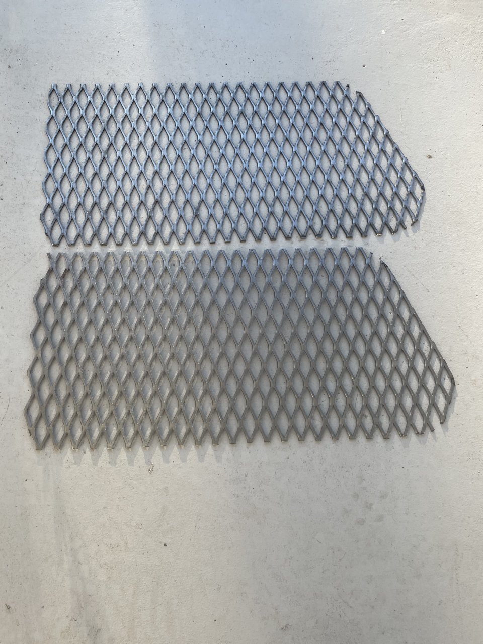

    Even with the prices of everything soaring lately I was able to do this project for under $40. The expanded metal is definitely the most expensive part so I went to a metal warehouse and got those pieces sold to me as scrap from a much larger sheet and only paid for the steel by weight.

    2 pieces of expanded sheet metal 25"x12" that will be trimmed to fit with a cutoff wheel
    22 3/8" one hole conduit straps
    1 can flat black spray paint
    Start by removing the window screens (if your dogs haven't ripped them out for you yet) since the expanded metal sits on the aluminum frame and the screen covers that.
    Once removed place the 25"x12" expanded metal sheet into the window cavity and mark with a sharpie where you need to cut to fit and do the trimming with a cutoff wheel.
    Once you have both cut to fit switch out the cutoff wheel for a grinding wheel and smooth out all the edges. Then clean the metal with a wire brush before painting.

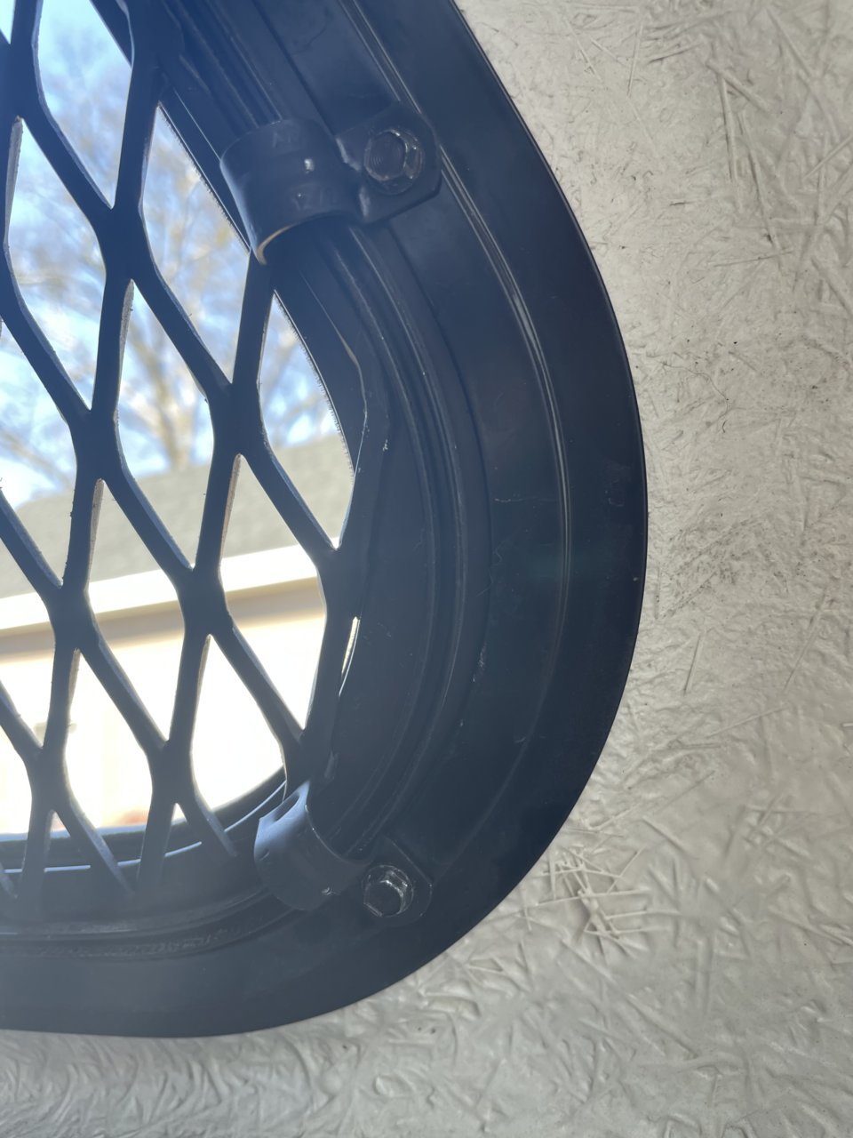

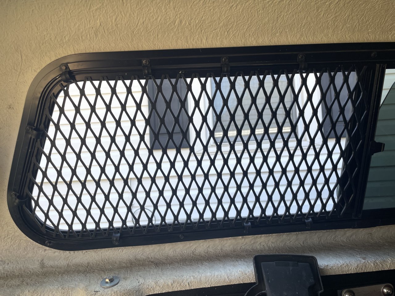

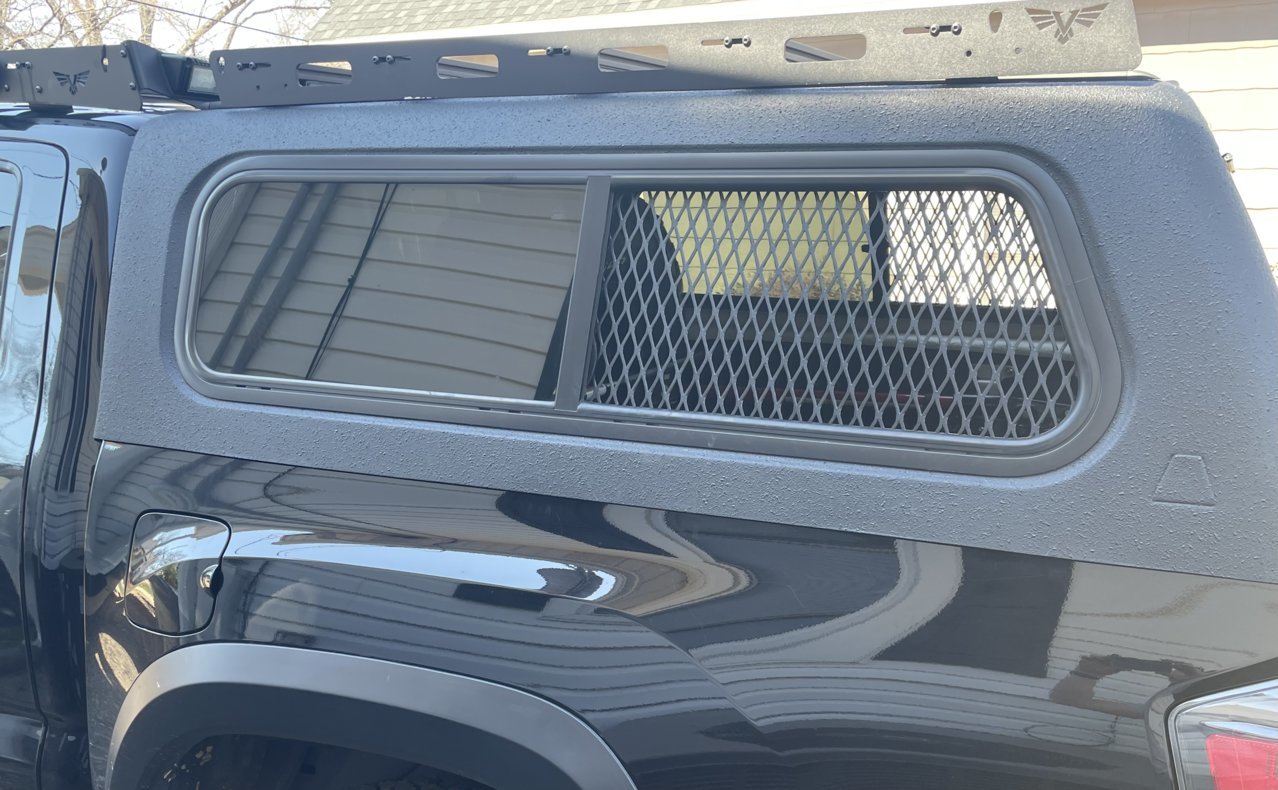

    Just did this project, took about as long as it did the paint to dry on the expanded metal. Painted them black to match the ARE Overland topper. Used the same hardware pictured on the original post. I was able to retain the bug screen with whatever style windows I had, so win/win there. Total cost was about $40 with the conduit straps. Pictures attached.
