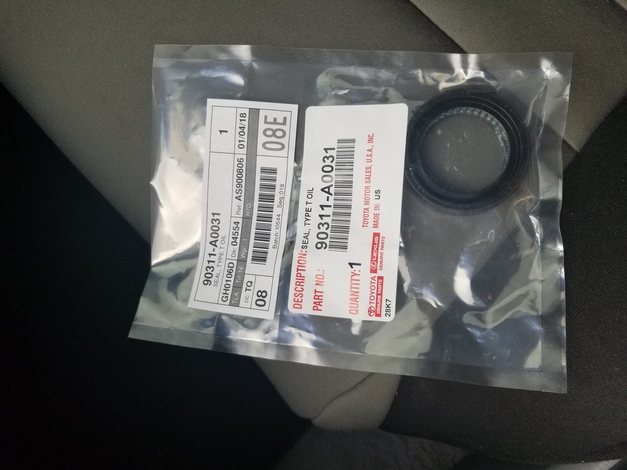

    From what i understand, 90311-40001 is the ORIGINAL seal which was since replaced by 90311-40034 and today i went to the dealer and part number had again been changed to 90311-A0031. Just for those curious and its listed for 09+ 4.0 5speed auto trans.

    90311-A0031 is the latest seal, it replaces 2 previous part #s in last post .
