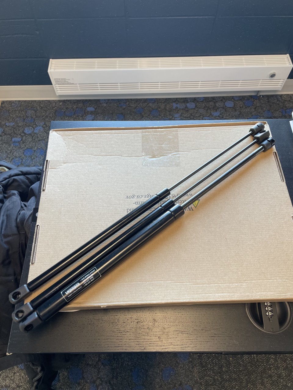

    DIY hood struts!
    Super happy how they turned out. I initially installed 100 lbs struts but they are way too overkill. I am replacing them with 40 lbs ones right away. Hopefully they are much better.
    Here are the parts:
    C16-08316 20" 40lb Per Gas Strut Shock Lift Support for RV Door Bed Storage Truck Tonneau Cover Camper Shell Rear Window and Other Heavy Duty Box Lid, Set of 2 Vepagoo
    20" struts
    $12 10MM Ball Stud Mounting Brackets for Gas Struts Lift Supports Shocks Spring Prop Silver 4PCS, with 16 pcs Screws
    10mm ball stud mounting brackets
    You could use a little longer strut if you want the hood to open higher. I wasn't interested in this because my ditch lights are close to hitting the windshield with the hood prop rod.
    These are installed just like Spiker.
    The driver side strut does have minor contact the fuse for my subs but I'm not worried about that.
    The strut also slightly touches the brake fluid reservoir when lowering. Also not worried about that.
    More information to come!

    2013 Super White Tacoma TRD OR Access Cab
    How did you calculate the mounting points for the length of struts you used?
    TRDSport10 and dpele[OP] like this.
  11. Jan 28, 2022 at 3:05 PM
    dpele
    dpele [OP] Pele Prints Vendor
    Apr 13, 2016
    #184159
    981
    Dan
    Edmonton, Alberta
    2010 Tacoma DCSB
    Elka 2.0 w/ OME Dakars, 285/70/R17 Duratracs, & more!
    I followed the Spiker installation manual. I had to do a couple easy modifications. Not hard at all.
    I attached Spiker and Redline install documents here.

    Update:
    • Originally had 100 lbs struts (Vepagoo) - way to strong. It was too much to pull the hood down.
    • Replaced with 40 lbs struts (Vepagoo) - hood would not raise on it's own, but it would stay up. Too weak.
    • Replaced with 80 lbs struts (Red Hound Auto) - nice and strong lift. Decently easy to pull down. Still firm.
    I will be keeping these 80 lbs struts. I think the 60 lbs would work, but not sure it would lift a hood with snow/ice on it.
    These Red Hound Auto struts are much smaller than the Vepagoo brand. I was a little scared when doing the initial pre-installation compressions. I thought I was going to bend the rods.

    Dpele,
    Getting ready to order struts for this mod. Could you please update and tell us again how the 80lb struts are working for you? I'm leaning towards the larger diam. Vepagoo 60lb struts. My 3rd Gen. 4runner uses 24" struts. Is 20" long enough for your Tacoma, or would you go longer now that you have some experience with them?
