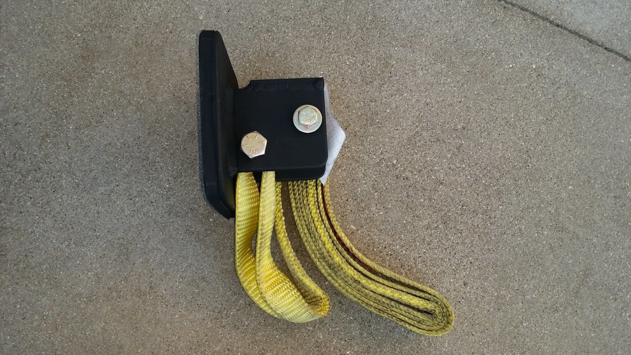

    Search The Forum and didn't find anything like this so I thought I would start one myself.
    I'm the kind of guy that would rather build something than buy it.
    Here is the first accessory I thought I would need

    How do you use it?

    This one I hope to use in the future. When I get my sliders.20201218_152712.jpg 20201218_153200.jpg

    It's a copy of the Hi lift lift mate. Just no hooks.

    The question was "how do you use it", not "what is it" You still haven't explained or shown how to use it, especially with no hooks

    Would be nice to see how it works. I guessed basket the slings? I could imagine other uses but surely not for removing a damaged and flat tire.

    Yes the sling gets wrapped around the wheel spokes until it's just the right length then both looped ends are capture by the bolt in the bracket I made.
    My plan for this is just for recovery situations.
    1. Wheel stuck in a hole. Jack up that wheel fill that hole with rocks and dirt. Set it back down.
    2. Flat tire. Jack up the wheel set it down on a jack stand or rock if need.
    I'm sure there is more situation where it will be useful.
