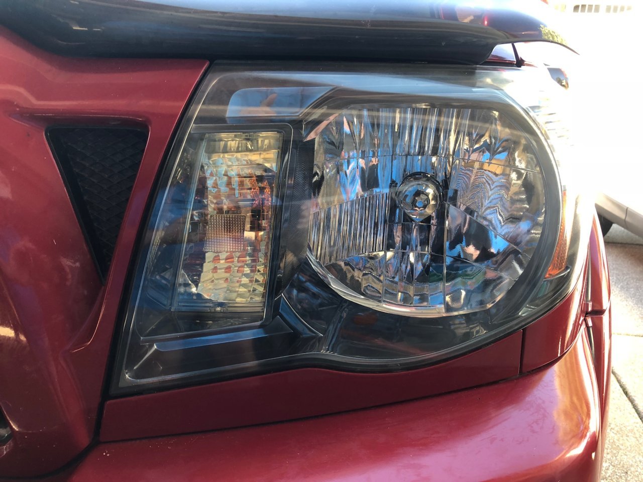

    crashnburn80 is spot on regarding the UV protectant. It should be a routine maintenance thing. There are several UV protectants out there and some supposedly are good for a year. I don’t trust going a year or longer. What ever one you use I would apply it at least twice a year. Add it to your maintenance program and you’ll have clear headlight lens for a long time

    BA25E4D3-892D-4D86-A8E5-12267B59400E.jpg Here’s a pic of one of my headlights today after using Mcguires heavy duty head light restore about 2 1/2 years ago. I just put UV protectant on periodically and they stay clear as when they were new. Before I used Mcguires they were grossly oxidized. 2 1/2 years later looking good.
