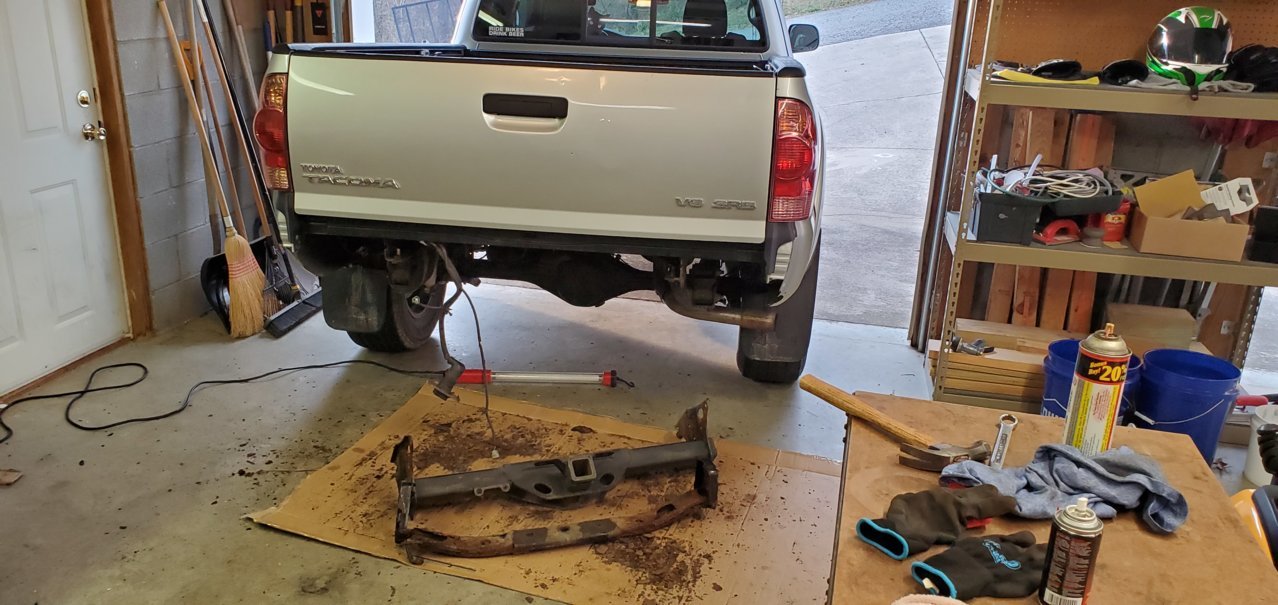

    I tore into it today. The tow bar is fine but the bumper support is toast.

    The previous owner was somewhere in the salt belt. Here in Western NC the roads only get salt a few times a season. I can't explain why the bumper support is in so much worst shape than the hitch, it's a lighter gauge material but that wouldn't account for all of it. The bed is not off yet, but I took a good look at the frame, armed w/ a chipping hammer and it's not as bad as I imagined. At the rear the worst seems to be in the front leaf mount area. The front is boxed and looks good but that doesn't mean it is.

    The hitch might have been replaced which is why it appears so much cleaner than that support member. The support member is also flat and a perfect place for salt brine and crap to just sit and rot away the metal if not thoroughly rinsed.
