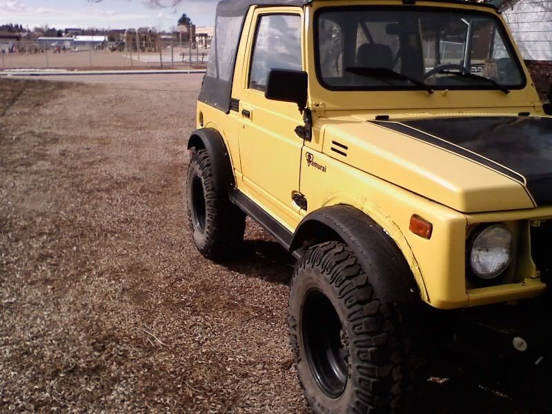

    Classy and free! Make them as wide as you want :) (and yes that is/was my samurai)
    I came up with the idea after a hunting trip with the stock flares. Having softball sized lumps of mud whiz past your face at 100mph to slam into the inside of your windshield gets your attention.

    Did you just bolt thru the tire?... Very very cool

    Self tapping screws, got the tire for free from the scrap pile at the tire shop and took a sawzall to it. A couple hours and it was done.
