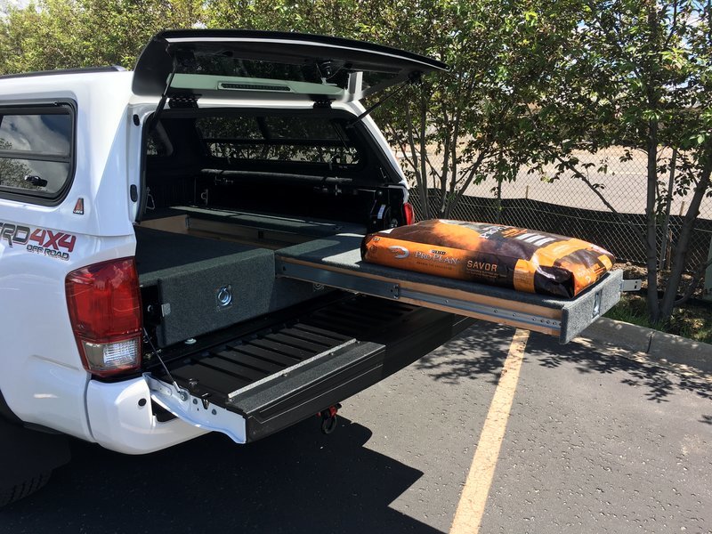

  10. Jul 13, 2017 at 12:33 PM
    upTOPOverland_Drew
    upTOPOverland_Drew upTOP Overland Technical Design and Application
    May 22, 2016
    #187612
    2,708
    Drew
    Littleton, CO
    2017 TRD OR DCSB SUPER WHITE
    All the things...click the link in sig
  11. Jul 13, 2017 at 12:35 PM

  12. Jul 13, 2017 at 12:37 PM
    upTOPOverland_Drew
    May 22, 2016
    #187612
    2,708
    Drew
    Littleton, CO
    65 qt RTIC loaded to the brim and 2 6 gallon jugs...300 lbs so yes lol solid as a rock at full extension and even on some rough trails
  13. Jul 13, 2017 at 12:43 PM
