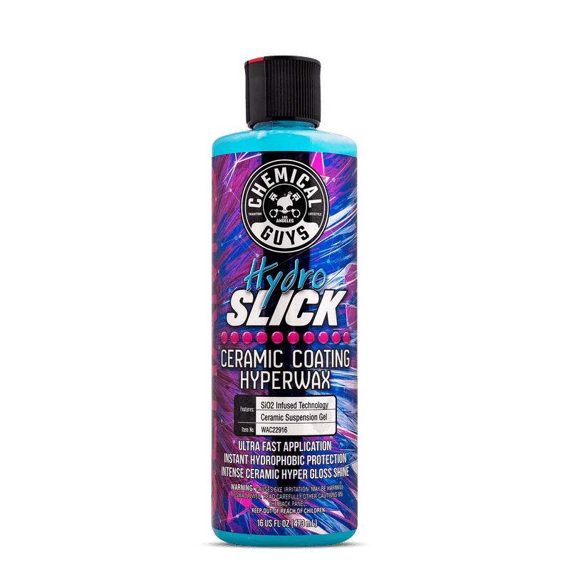

    I tried this stuff. I really didn't notice much difference in shine but the way it sheds water is impressive. Fairly easy to apply. It works great on the glass and is way better than rain x. The only downside is the price. Once this bottle is done I will give the Turtle Wax a try.
