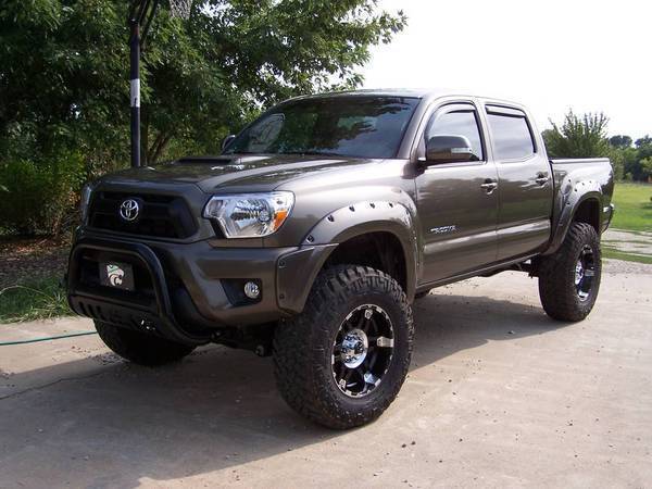

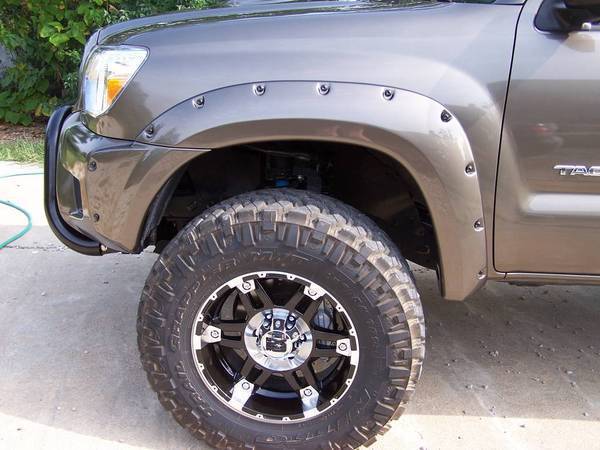

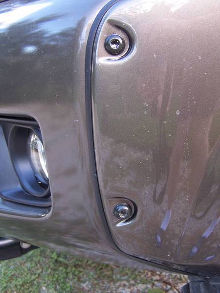

    I just recently installed a new set of Bushwacker Pocket Style fender flares on my 2013 DCSB. These come with installation instructions, but some of the steps aren’t totally clear so I thought if anyone else performed this mod some pictures might help. They come flat black with silver metal bolts. I had the flares painted to match my truck and the color is spot on.

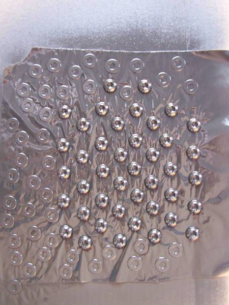

    I am going with an all-black accessory theme with mine so first I spray painted the bolts and washers using primer and then matte black. I just used a cardboard box with holes punched in it to old the bolts. I put down a piece of wax paper to try and prevent the bolts and washers from sticking to the cardboard. It worked pretty well.

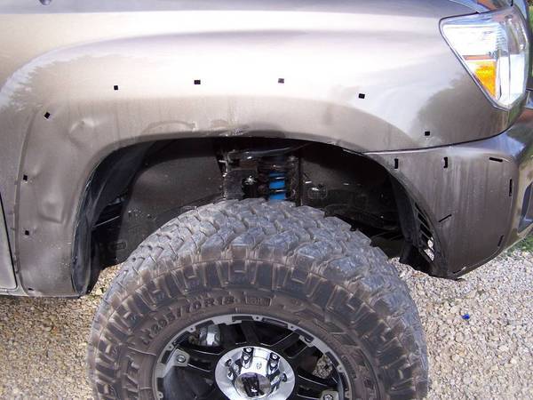

    Then you attach all of the bolts around the edge of the fender flare. The factory fenders and mud flaps have to be removed which is really easy. I started with the back ones. Just take out the bolts on the underside of the wheel well and pull from the bottom on one side and work the rest of the way around. It will pop right off.

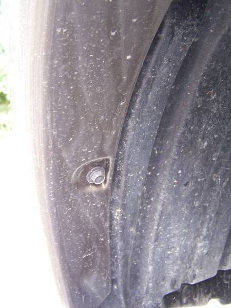

    The main flare on the front comes off the same and is just as easy, but don't forget to take out the two bolts up under the wheel well in the middle.

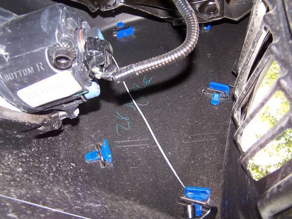

    It pops right off. You have to take some pliers and turn out the plastic clips that held them on. The blue ones come out real easy, but the orange ones will fight a little.

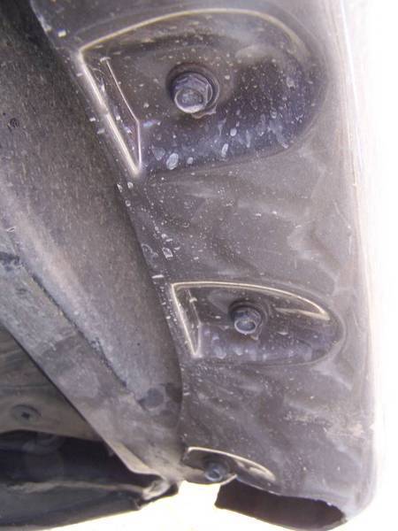

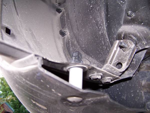

    The small flare on the front bumper was kind of difficult to remove only due to the clips holding it in place. First you must remove the two screws on the bottom edge of the bumper holding on part of the black plastic wheel well. Then pull it toward the wheel and down to expose the blue clips that need to be removed.
    There are seven that have to be removed and about three of them are hard to get to, but it can be done.

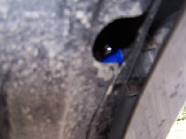

    There is one clip at the top hiding that you have to get to through a hole in the wheel well.

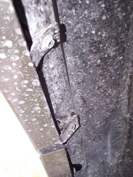

    I used a flat head screwdriver to push the tab on the clips to get them out. Like I said, this part wasn't very fun, but it is doable. Once the clips are out, the front piece will fall right off.

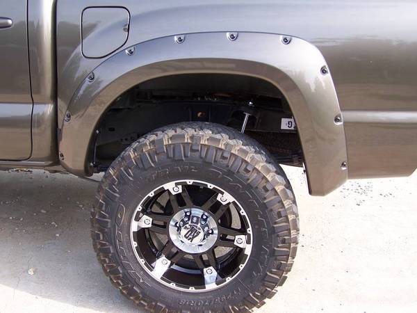

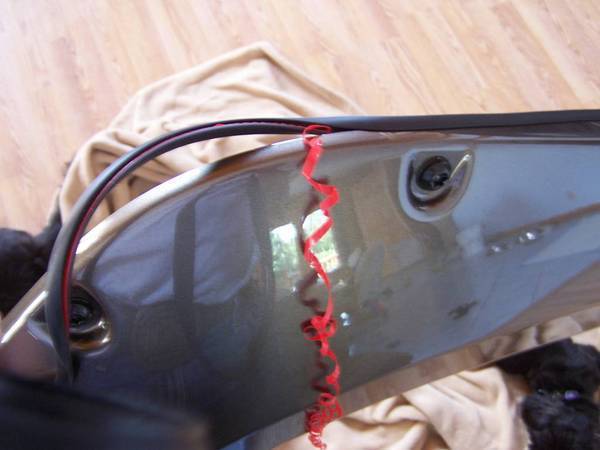

    Next I put on the rubber stripping that comes in the kit. Just do as the directions say, pull a little bit of it off and push it around the edge. Goes on easy and just cut it off when you get to the end point. Make sure you know exactly where the end point is before cutting though. May have to hold it up next to the truck to see where it makes contact. Pretty straight forward though.
    Then you're ready for installation. The rear ones just line up with the factory holes and you just put in the bolts that are supplied with the kit and tighten down. Be sure not to over tighten because they are just screwing into plastic. There is a little spacer that goes on at the back end to add additional support.
    The front two pieces bolt together and then are placed onto the truck as one piece. There are two black clips per flare on the front that use two little black screws to hold it up in the middle. Follow the directions by marking the spot where they need to be and stick the clip in the sheet metal with the hole facing downward.
    Three bolts go on the rear and one bolt on the front, then the two little screws in the middle.

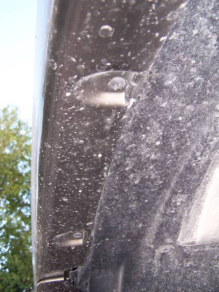

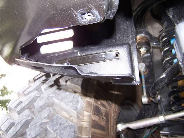

    The front piece that attaches to the bumper needs to have two holes drilled through it for the flare to be attached. You are just drilling through the plastic bumper, so it is real easy. There are four longer bolts that match the other 42 little ones and this is where they go. Bolt them on and the fenders are installed!
    Go back and lift up the piece of black plastic wheel well and use the screws you removed to reattach it.
    That is all there is to it!
    Pretty easy and mostly straight forward, just takes a little time. I'm guessing it took me about 3 hours or so total. Let me know if you have any questions. Good luck!

    Looks awesome man! Can't wait to install mine weekend. Quick question though, did you have to paint the washers? I am painting the bolt heads, but wasn't sure if the washers stuck out enough to need painted.

    I did paint the washers because they stick out a little past the bolt head. Not sure it would be too noticeable unless you looked close. Look at the closer picture I have of the flares on the bumper and you can kind of see the washers. I just figured I'd do it before installation because once they're on, if you want to change them, the flare has to come back off.
