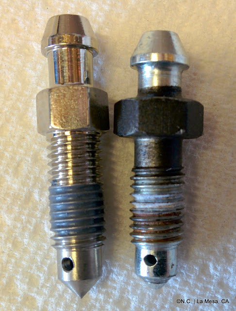

    To make this work, I bought four (4) speed bleeders and installed them in the truck. These new bleeder screws have an internal one way check valve utilizing a spring and ball, they let fluid and trapped air out, but do not let air back in. So far they are working great for me.

    Here is a front factory bleed screw compared to my new stainless ones.

    The ones I used are slightly longer than stock, the shorter screw will not work.. Here is what I used:
    For Second Gen 4x4 the application is
    (2) SB7100 (Front Disk brakes) M7 x 1.0 x 35.15
    (2) SB1010 (Rear drum brakes) M10 x 1.0 x 34.44
    http://speedbleeder.com/automobile_applications.htm
    New vs. Stock
