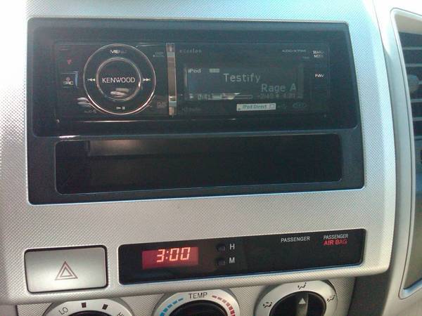

  20. Jun 19, 2010 at 1:37 PM
    #140
    shanomac
    shanomac Senior Member
    Apr 23, 2010
    #35860
    39
    Massachusetts
    '10 SR5 4x4
    Sounds fantastic with the new JL 6.5" speakers and the Kenwood HU. Can't believe how much volume there is. Spent a little time with the SWI-JACK steering wheel interface, but got it figured out. Off to take a drive and crank up the volume!
