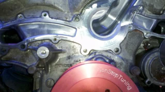

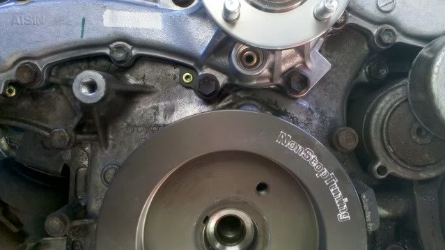

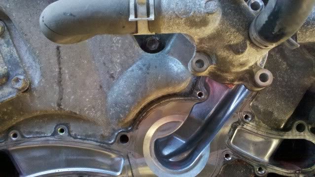

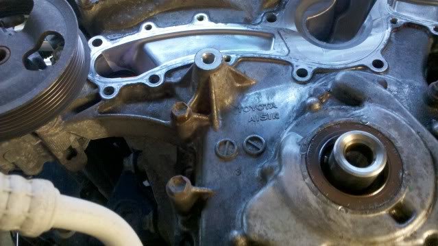

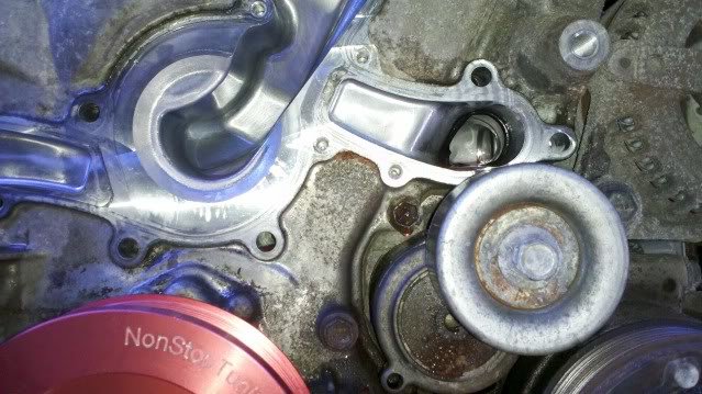

    Unbolt water pump in a star pattern, and thermostat assembly. Look in picture of water pump. Use your hand to feel around for hidden bolts. The upper assembly where the top radiator hose attaches to has two hidden bolts, one on each side of the bottom. Also you’ll need to move the belt tensioner to get to the bolt behind it. Unbolt 2 pulleys.
    Step 8.
    Place towels to catch excess coolant from water pump. Remove water pump . it’s a little tricky with the upper assembly but you can manage to slide it out. Next remove water pump gasket.

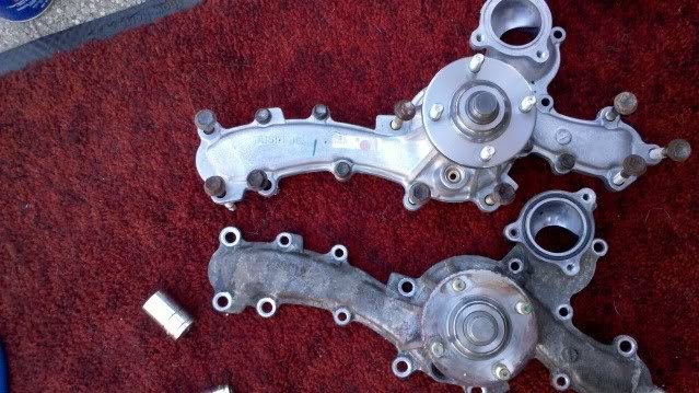

    Step 9.
    With new water pump add the O ring, remove old thermostat w/ housing and place in new O ring and thermostat w/ housing (you can see the black housing in pic one).
    OEM water pump is made by Aisin.
