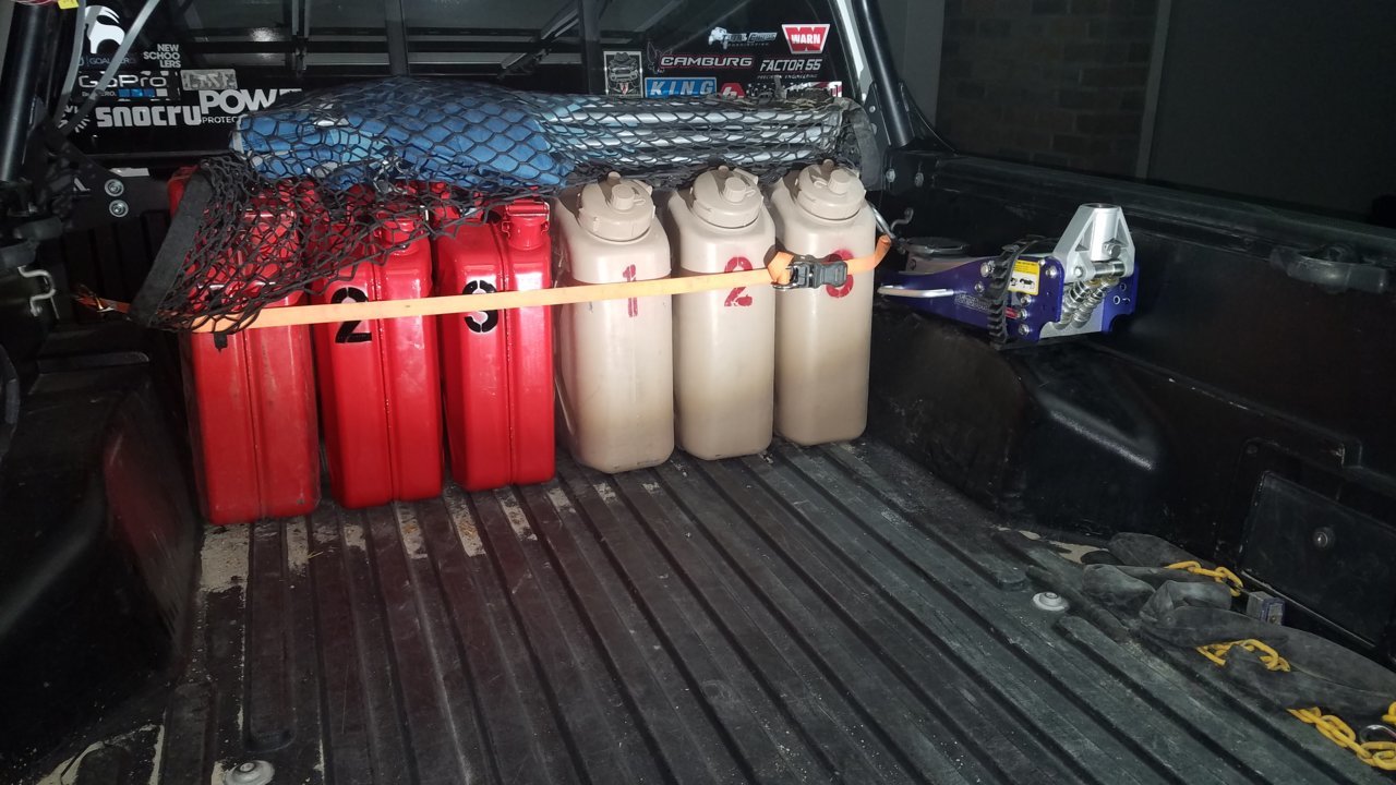

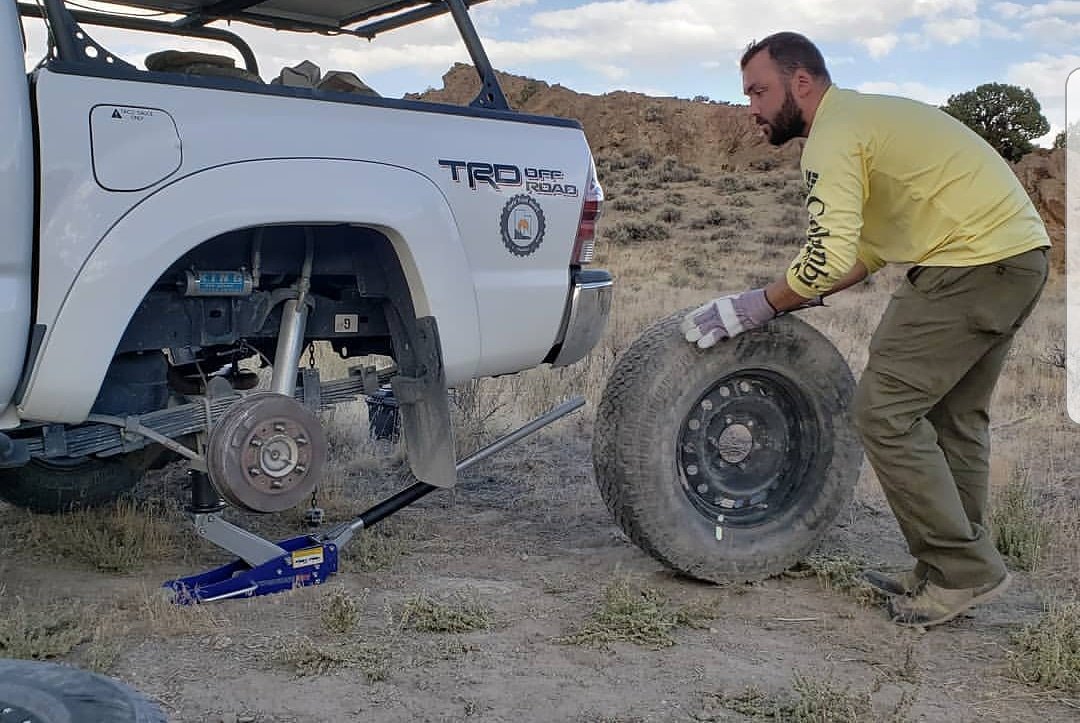

    I had the same issue. I went a little different direction.
    Even works in the dirt!

    My hi lift is next on my list but for now I also bring my floor jack whenever I take a longer trip where I don't want to be up the creek with a flat.
    I have used the stock bottle neck jack once off road and I didn't trust that shit one bit, and since I was offroad I just jacked it hi enough to support the truck and used a shovel to dig out under the tire to drop it down and replace.
