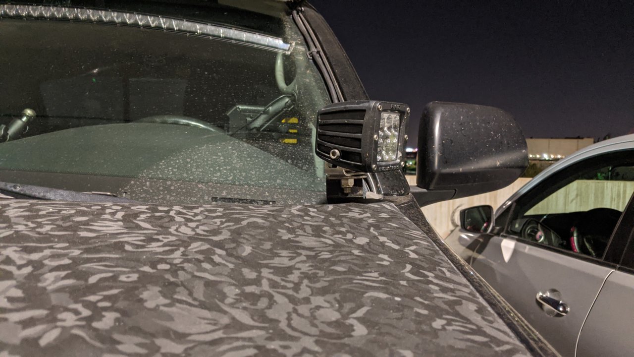

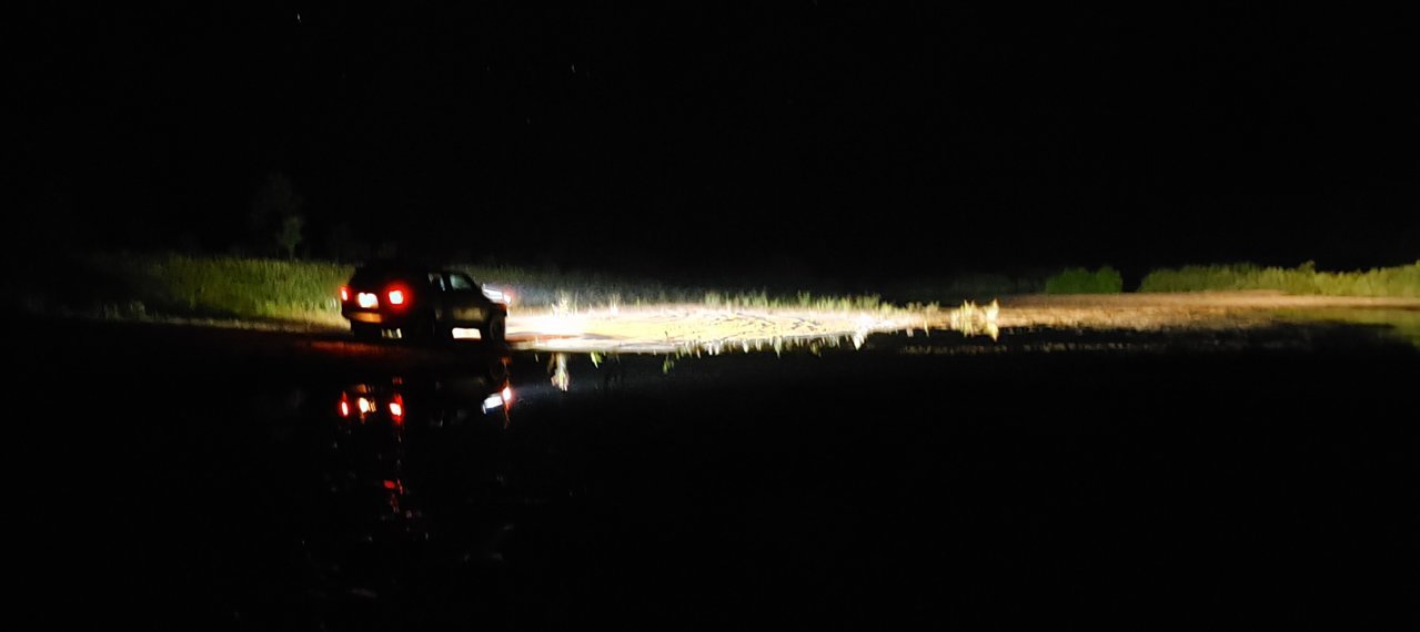

    Locker anytime Fog Lights anytime Full LED light conversion TRD cat back Rear cat delete Exaust Y reroute away from actuator Alloy Clutch master 2000 4Runner "Dog Leg" shift leaver Marlin shift seats and bushing Rear seat delete Rear diff breather extension Chrome grille swap Debadge Rear seat delete Honda blower motor beefy plug and wire mod Anytime 12v and USB with volt gauge in bed Blue Sea fuse box Hella AND 70's Caddy horns Low profile recessed hex drain plug swaps Alluminum battery strap 7pin relocated Backup cam on anytime Various other creature comfort and personal taste mods.
    I have Rigid "Driving" right now, I think I'll go Flood or side ashooters next though and use these for back up lights in my new plate bumper though. I mainly use them for their implied name, lighting up ditches.
    I put mine on separate switches on the door sail panel so I can turn them on individually.
    I use them when looking for badly marked roads in the dark or when wheeling for making sure I don't go into the ditch, lighting up what is alongside me and just giving a wider field of view ahead, I wish they gave light out even further 90° to direction of travel.
    I have them mounted at a slightly greater than 45° angle from direction of travel and a few degrees down they pickup where my headlights drop off on the side sweep and thanks to the angle I can run the passenger side one without blinding oncoming drivers, I do this when I'm in the sticks for spotting animals on the shoulder without using my top mount bar.
    Works great!
    :thumbsup:
